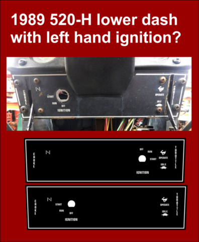

1989 520-H LOWER DASH IGNITION PLACEMENT
Vinylguy
Left hand ignition switch placement on most 520's seems to be on the right side of the dash but I have had
a couple requests from customers who have theirs on the left side?
Wondering what years or what difference their is in a tractor with left vs. right?

My 1988 520-HC came on the left side.
I replaced the dash and moved it to the right side as I prefer it there.

From the 520-x parts lists
1988 and 1989 decal number 113911 - Ignition switch on the left
1990-1995 decal number 119230 - Ignition switch on the right
1996-1997 decal number 119230 for North American models - Ignition switch on the right
1996-1997 decal number 93-9396 for export  models - Ignition switch on the ?
The 113911 was replaced by 119230. Wonder how that worked for them?

Funny thing is that only my HC had it on the left.
My 1989 H had it on the right.
I guess the best thing is to just verify where yours is before ordering a decal.
The wiring will reach either side if you ever want to change it out.

I think I will just include left and right on all pre TORO 520 kits.
