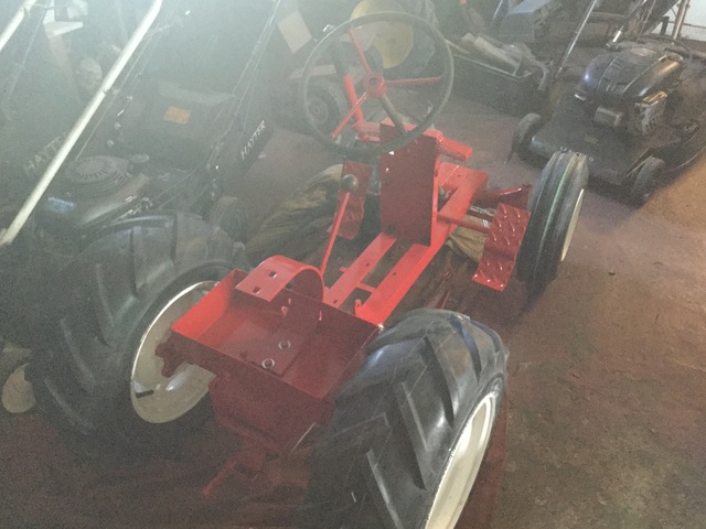

nigel 150 #31 Posted December 15, 2016 Not having much luck with this project, got the wheels back from powder coasters took them to have new tyres fitted and they have knocked big chunks out of the coating 🙁 Share this post Link to post Share on other sites

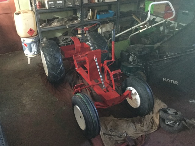

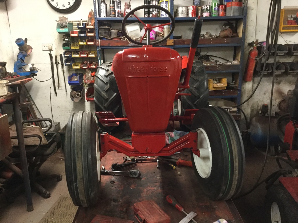

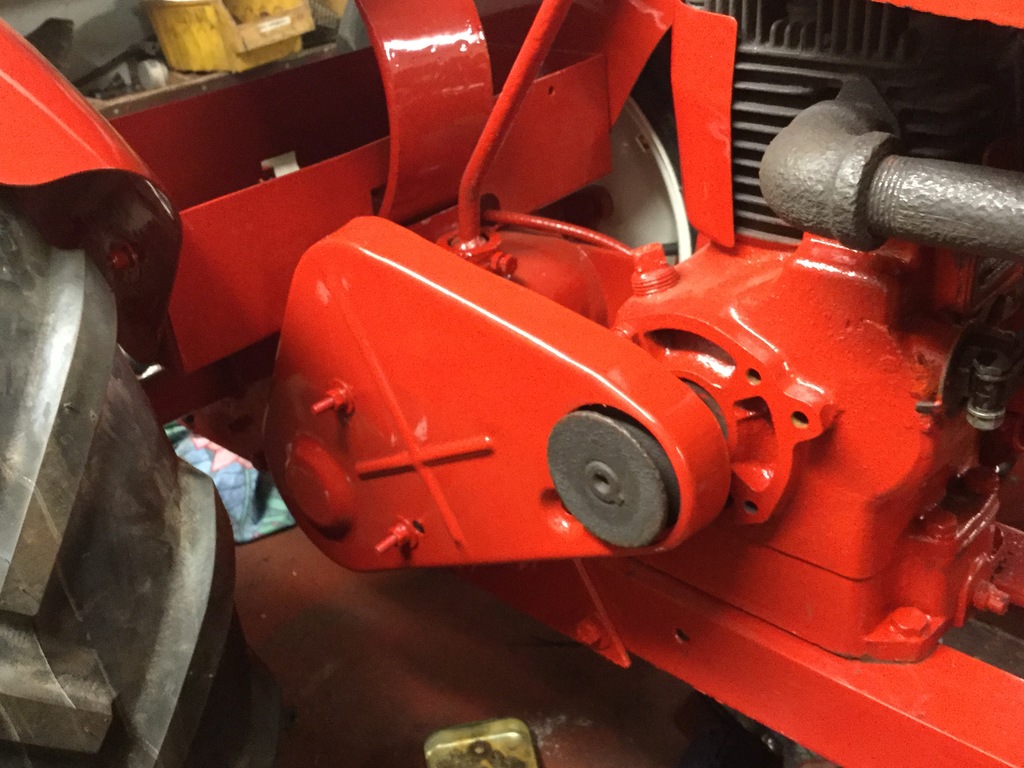

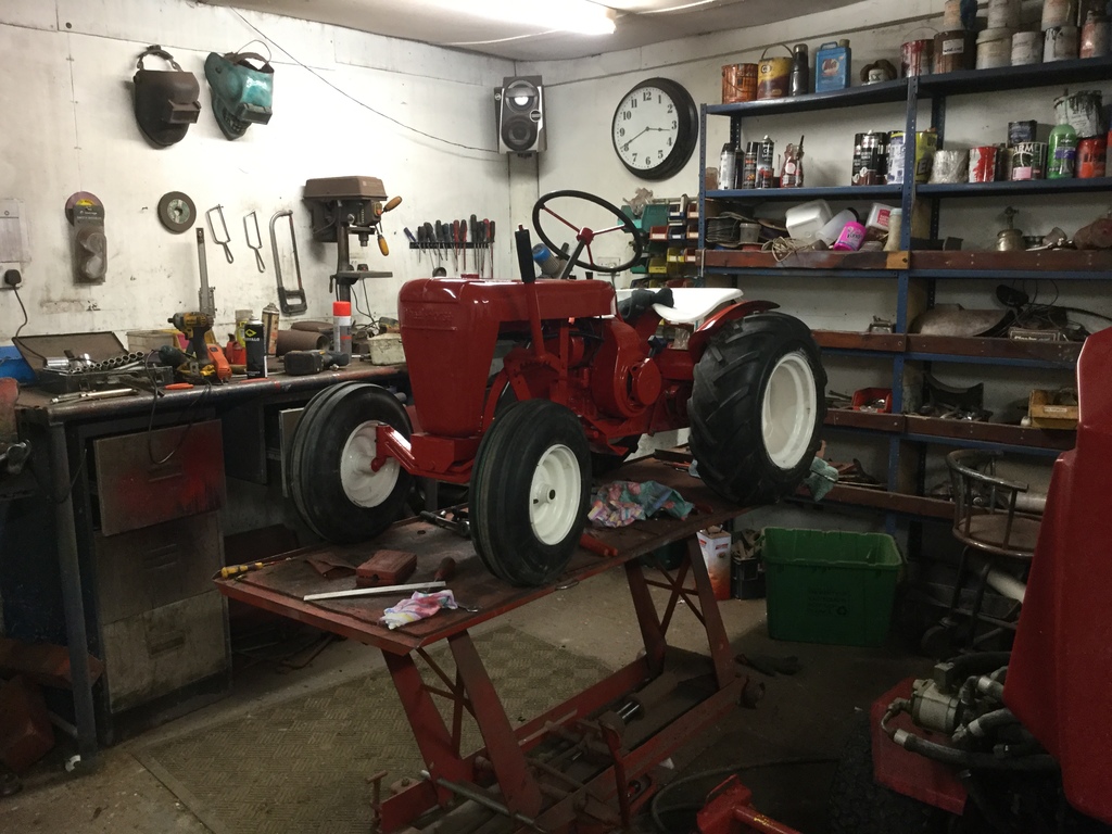

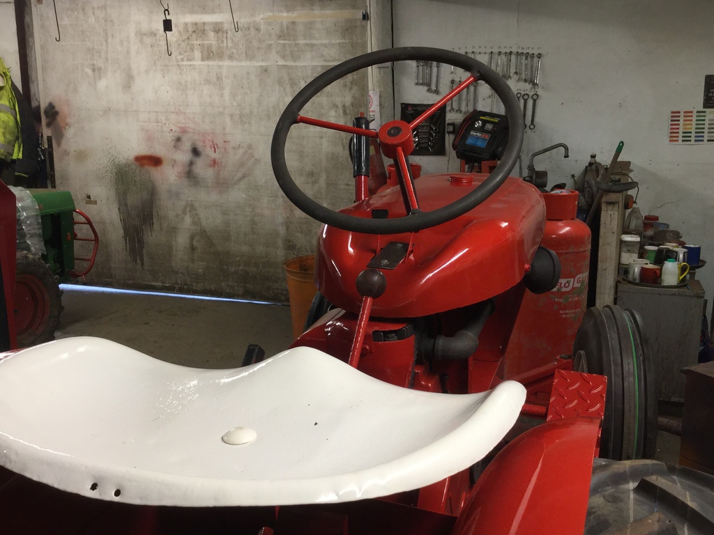

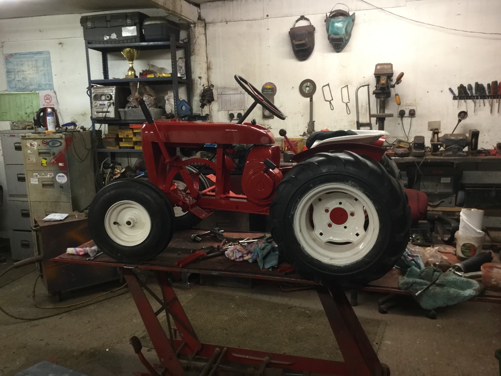

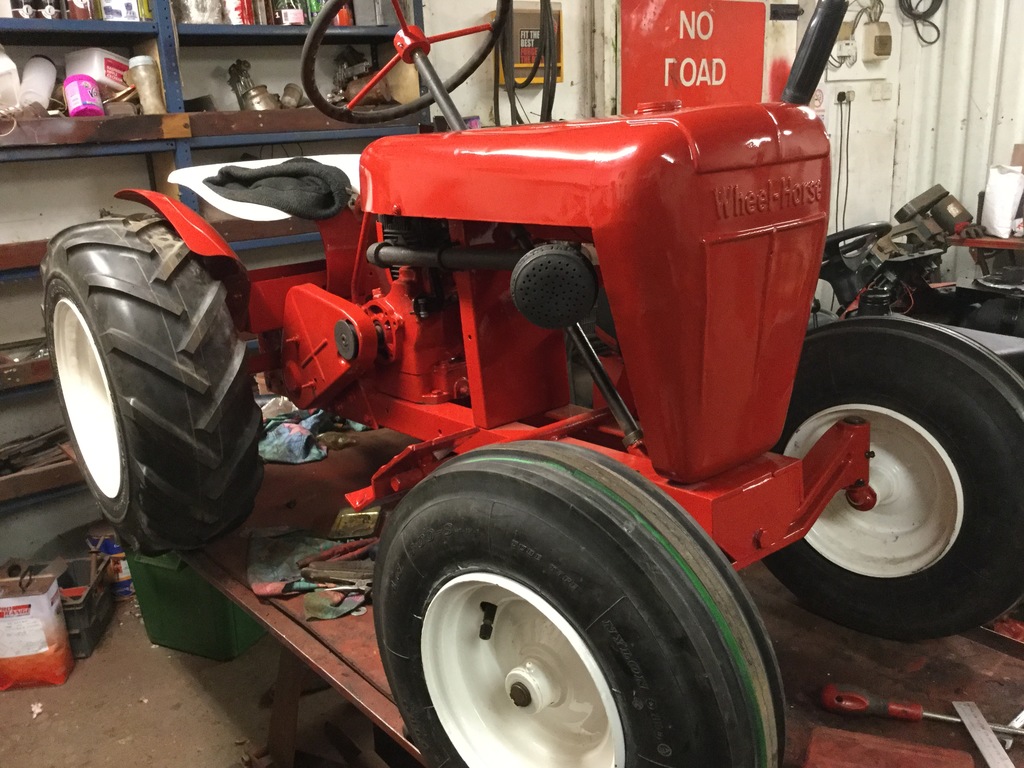

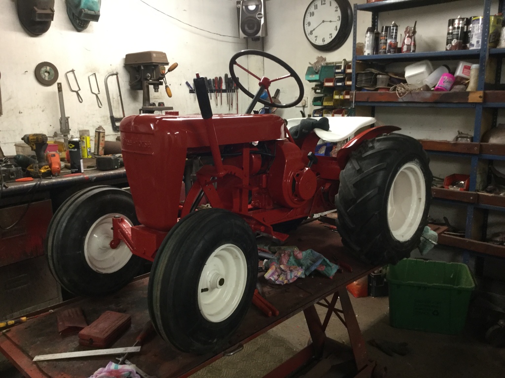

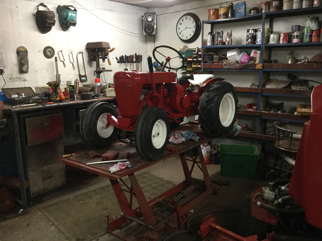

nigel 150 #32 Posted December 17, 2016 Well tires are on and new exhaust made it's not quite finished in the picts 4 Share this post Link to post Share on other sites
nigel 150 #33 Posted February 8, 2017 Just waiting for decals noeNoe 4 Share this post Link to post Share on other sites
