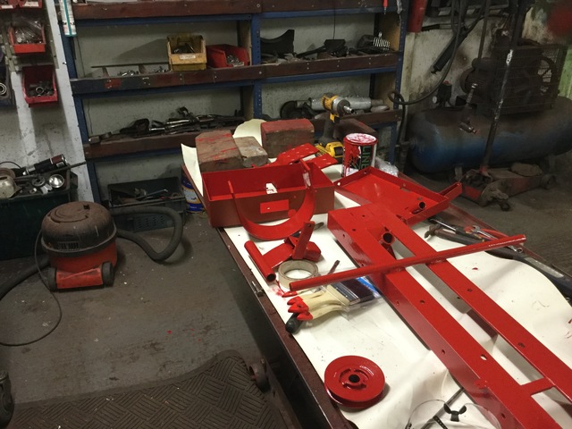

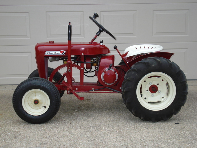

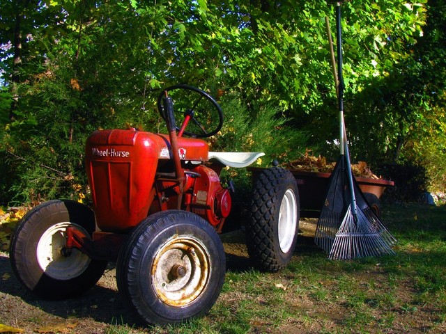

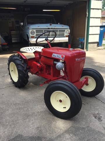

nigel 150 #1 Posted November 19, 2016 (edited) can anyone tell me the propper dark red colour for the 1960 suburban please and has anyone got close up photos and sizes of footplates many thanks Edited November 19, 2016 by nigel 4 Share this post Link to post Share on other sites
953 nut 60,334 #2 Posted November 19, 2016 Most of us use International Harvester Red, but other shades are good too. 2 Share this post Link to post Share on other sites

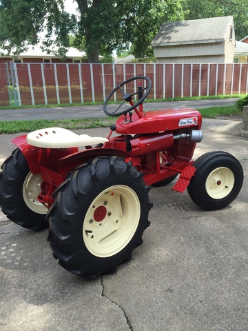

nigel 150 #3 Posted November 19, 2016 I've always used international haverster red before but it's very bright, the above pict I think is member AMC horse it's a lot darker and I think it's nearer the original colour and I really like it , now international red is darker than harvest red and I wondered if it was that Share this post Link to post Share on other sites

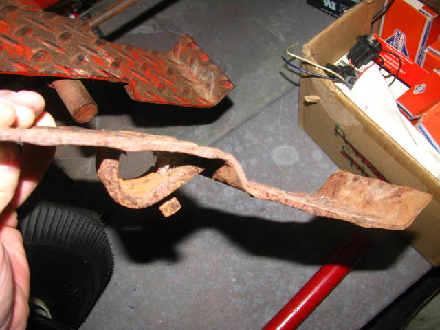

AMC RULES 37,211 #4 Posted November 19, 2016 (edited) A bit of the original paint still survives on this '60 model 400 Nigel... ...seems to me, the closest match would be some IH(International Harvester) type of red. Edited November 19, 2016 by AMC RULES 7 Share this post Link to post Share on other sites

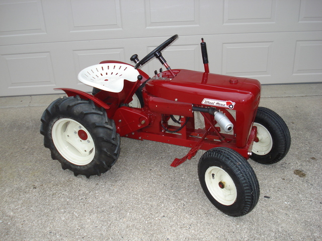

nigel 150 #5 Posted November 19, 2016 I still prefer the colour of the one in the Picts that I posted at the beginning of the thread as you can see it's definitely a darker red, but what one ? 🙄 Share this post Link to post Share on other sites
AMC RULES 37,211 #6 Posted November 19, 2016 Rustolem Regal Red would be my best guess here. 3 Share this post Link to post Share on other sites

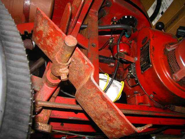

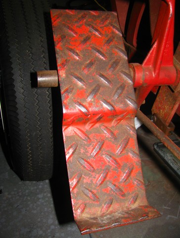

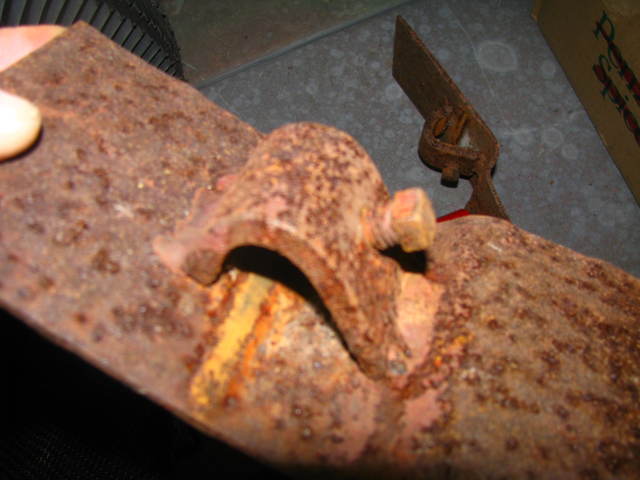

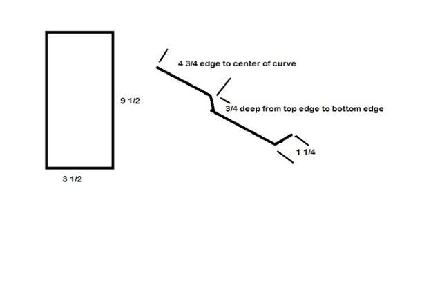

nigel 150 #7 Posted November 19, 2016 Many thanks, just one more thing boys, as you have probly guessed I have one of these ime rebuilding at the moment and the foot plates are missing not a problem for me to make them now I have the measurements, but has any one got a photo cos I don't know how they fit on the rod or whether they have foot treads on them, many thanks for your help Share this post Link to post Share on other sites
AMC RULES 37,211 #8 Posted November 19, 2016 Using the measurements Richard provided above... here's a few picts of them footrests, and how they attach Nigel. 4 Share this post Link to post Share on other sites
nigel 150 #9 Posted November 19, 2016 Thank you both so much that's exactly what I needed 👍🏻 1 Share this post Link to post Share on other sites

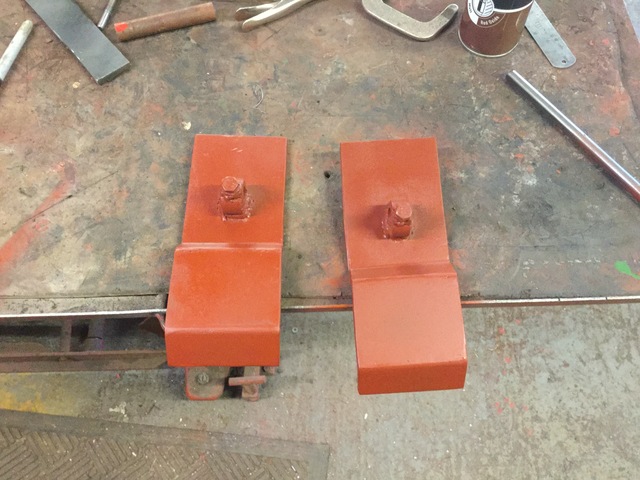

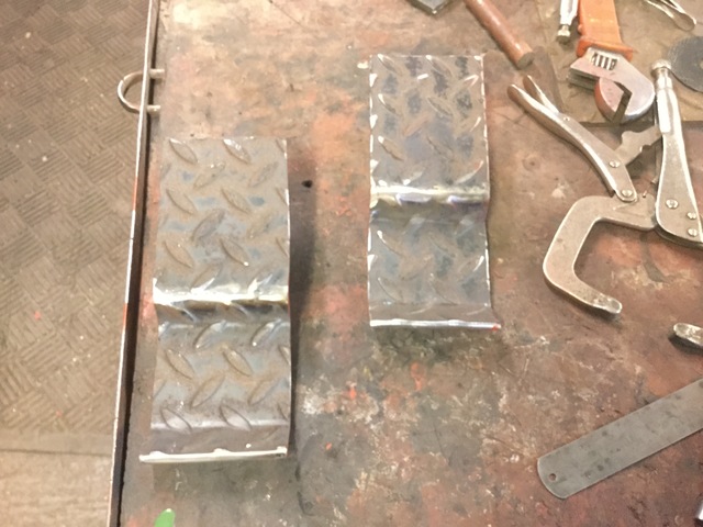

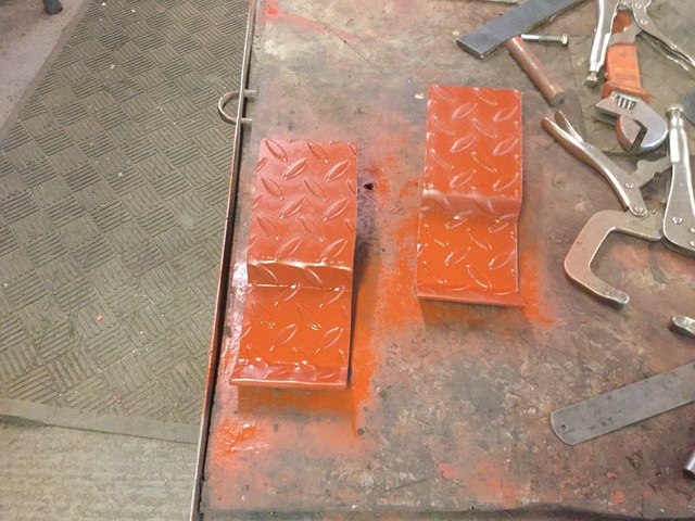

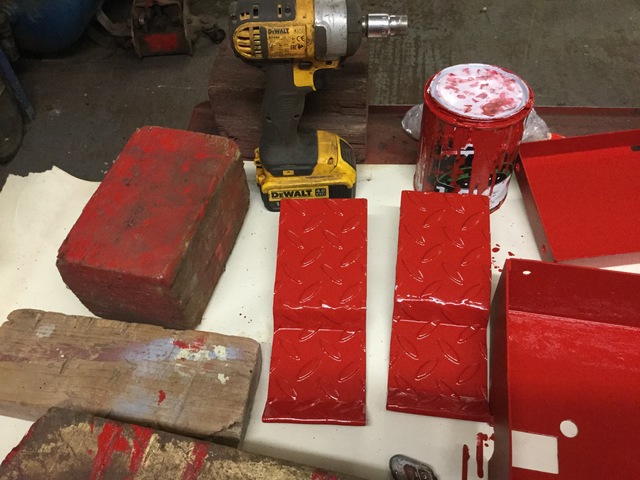

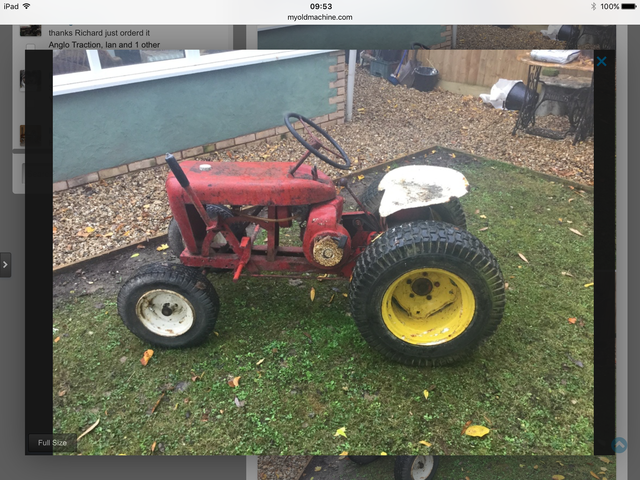

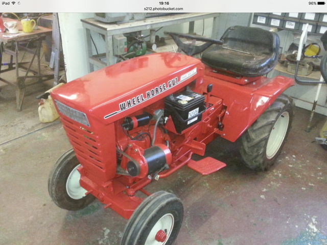

nigel 150 #11 Posted November 22, 2016 Well thanks to Richard and Craig's help I've made some, the only problem was the plate I had was thicker and didn't want to bend even in the press so I ended up cutting and shutting but I think they look ok He's a couple of Picts before I stripped it down It won't let me add any more photos ! 6 Share this post Link to post Share on other sites
AMC RULES 37,211 #12 Posted November 22, 2016 Foot rests turned out great... before pict is pretty cool too. 1 Share this post Link to post Share on other sites

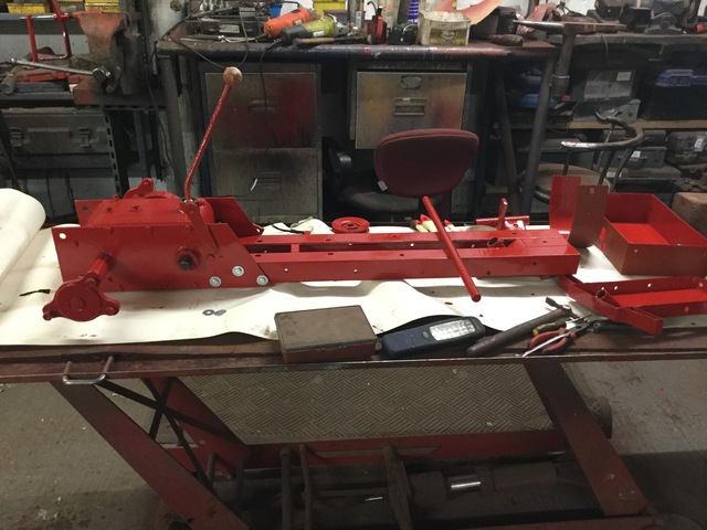

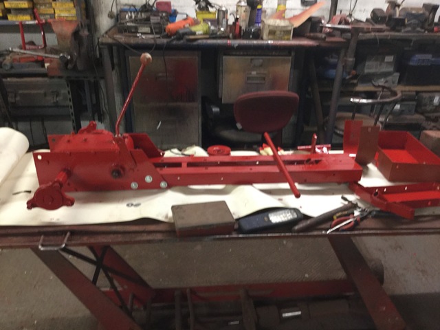

nigel 150 #22 Posted November 29, 2016 Bit more done 3 Share this post Link to post Share on other sites
AMC RULES 37,211 #23 Posted November 29, 2016 Old school baby. 1 Share this post Link to post Share on other sites
