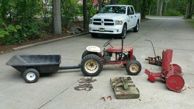

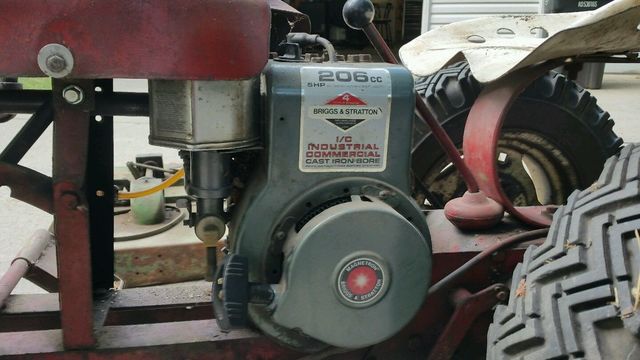

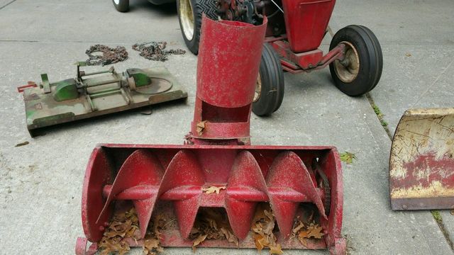

JERSEYHAWG / Glenn 4,499 #1 Posted November 18, 2016 (edited) I just found this, literally 10 miles from me. Is this engine correct. It has deck, plow, snowblower.....600 bucks Price,,,is it fair for this? How correct is this machine? Is anything right about It? The motor concerns me to. Ok, been doing some reading, this looks like a little bit of everything rig, like a mutt. Thanks, Glenn Edited November 18, 2016 by JERSEYHAWG / Glenn 7 Share this post Link to post Share on other sites

JERSEYHAWG / Glenn 4,499 #3 Posted November 18, 2016 1 minute ago, 608KEB said: I dig that snow thrower! Pretty cool right, but I would like to know on originality. Just asking, can't believe the stuff I been finding recently........... Glenn Share this post Link to post Share on other sites

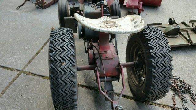

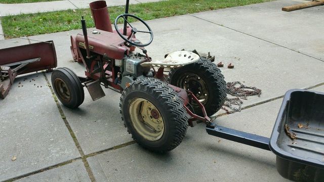

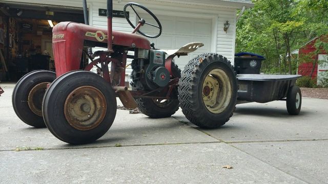

AlwaysLookin80 1,308 #4 Posted November 18, 2016 (edited) It's a 61 suburban for sure. Engine is incorrect and should be a Kohler k91. Fenders and tool box are missing and that together with the wrong engine and the hood being cut up in back really hurt the value of the tractor itself. The blower and blade are worth a few bucks for sure. The deck looks rough and missing some parts. The wheel barrel is a off brand, not really of any value. The most I would pay is 450, MAYBE 500 as long as everything worked. The 500 is if you really want the stuff. Hope this helps Edited November 18, 2016 by J.A. 3 Share this post Link to post Share on other sites

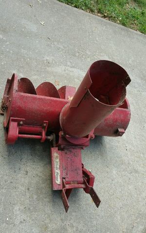

953 nut 62,508 #5 Posted November 18, 2016 Nice Suburban! A good sheet-metal worker can repair the hood and K-91s are easy to find. You have the trailer hitch which is hard to find and 608KEB is right on, the snow blower is great, but I think it will be a bit slow. Share this post Link to post Share on other sites

wallfish 18,652 #8 Posted November 18, 2016 1961 401. like others wrote, but wrong engine. The blower is a 1962 ST302/3072. Made to adapt to that tractor but missing the mounting adapter, lift bar, foot pedal, chute handle, chute handle support bar, chute rotating belt pulley and belt and the belt guard for the engine belt. All can be reproduced. Snow plow will fit and has the mounting adapter but missing the foot pedal to pull the index pin. That tow bar is from a 1960 400 because the rear hitch was used for the deck lift on that model. 3 Share this post Link to post Share on other sites

Hammerhead 817 #14 Posted November 19, 2016 The mower deck is actually a 1958 type. Footrests look home made. All in all it ain't too bad of a pile. Offer him $500 and hope he takes it. 1 Share this post Link to post Share on other sites
