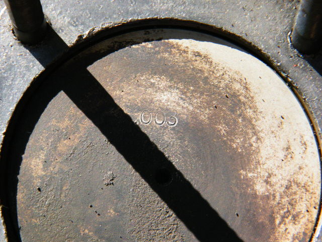

Achto 30,807 #4 Posted November 17, 2016 Strange indeed. Like you said oil should not be able to get past the valves while sitting. I wonder if the rings are a little sticky and it's taking a bit for them to expand & seal? This is not always easy, but if you can see the top of the piston. Look to see if it is carbon covered or if it is clean around the outside edges. If there are clean areas around the edges then you have bad rings. If the whole top of the piston is carbon covered then the rings are sealing as they should Share this post Link to post Share on other sites

stevasaurus 23,567 #8 Posted November 17, 2016 Here is a picture of what Achto is talking about with bad rings. Here you can see the clean area from 12:00 to about 5:00...bad rings. 3 Share this post Link to post Share on other sites
Achto 30,807 #9 Posted November 17, 2016 Great pic Steve! Perfect example of what most call "piston wash", caused by bad rings. 1 Share this post Link to post Share on other sites
