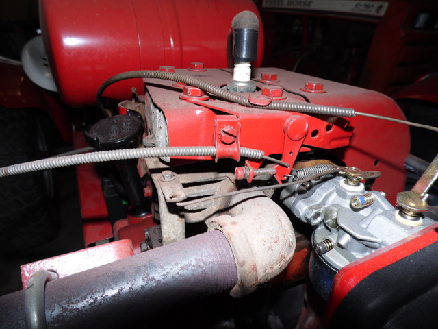

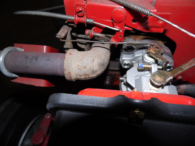

TONY65 15 #1 Posted November 17, 2016 I have a 654 with an H60-75063B Tecumseh on it that I have recently purchased, but the throttle and governor linkage has be disconnected. I downloaded the manual for this engine, but it is not 100% clear to me how the spring an linkage to the carb and governor are connected. Can someone with a 654 send me a picture of how these are supposed to be connected. Share this post Link to post Share on other sites
Molon_Labe 731 #2 Posted November 17, 2016 Tony here's a couple of pics of the governor and throttle linkage on my 654 4 1 2 Share this post Link to post Share on other sites
TONY65 15 #3 Posted November 17, 2016 Thanks Molon Labe that's exactly what I needed. 1 Share this post Link to post Share on other sites
305 381 #4 Posted November 17, 2016 if you don't have that rod they are easy to make from .060 Tig welding rod Share this post Link to post Share on other sites
TONY65 15 #5 Posted November 17, 2016 I found the spring and rod on RCPW.com, I was just unsure how they were connected together. Share this post Link to post Share on other sites

slim67 2,825 #8 Posted October 4, 2020 On 11/17/2016 at 7:38 AM, Molon_Labe said: Tony here's a couple of pics of the governor and throttle linkage on my 654 I noticed the cable end for the throttle is in the top hole in one pic and middle in second pic. Did one work better than the other? Share this post Link to post Share on other sites
TONY65 15 #9 Posted October 6, 2020 slim67, I had to put that project on hold not to long after I asked my question. So I don't know which one works best. I plan on finishing it when I retire in a few years. Share this post Link to post Share on other sites
