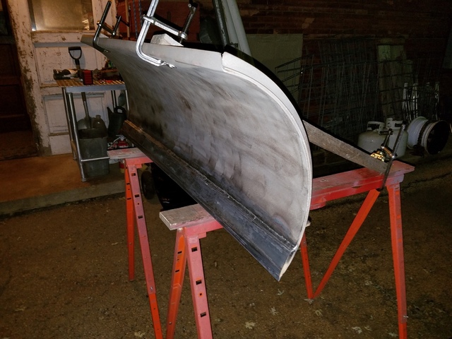

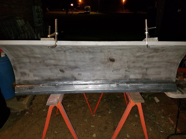

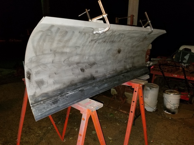

Sarge 3,470 #3 Posted November 16, 2016 Here is what I used - 1/2" x 60" pre-beveled 1055 steel http://www.discountsteel.com/items/1055_Steel_Beveled_Cutting_Edge.cfm Another Ebay source and a bit thinner - http://www.ebay.com/itm/3-8-x3-x66-Hardened-Cutting-Edge-1055-Carbon-Bucket-skid-steer-loader-tractor-/122004042520?hash=item1c6801f318:g:xOYAAOSwgQ9VhXPj My 56" blade was severely worn and damaged from the previous owner , so I had to weld it . 3/32" 7018 first pass , 1/8" 7014 final pass to fill/cap . Full length weld both front/rear . The damage was bad enough that the new edge couldn't be bolted like the original , hence welding it on . Just have to watch travel direction and moving around as well as heat input or you'll warp it badly . There are a couple other Ebay sources - 60" 1055 steel , pre-beveled just like I used - http://www.ebay.com/itm/Titan-60-Bucket-Cutting-Edge-Hardened-1055-Carbon-Steel-1-2-Tractor-Loader-/361569665662?hash=item542f3b427e:g:71sAAOSwyDxXhlfs 42" for the smaller blades/plows - again , 1055 steel http://www.ebay.com/itm/3-8-x3-x42-Hardened-Cutting-Edge-1055-Carbon-Bucket-skid-steer-loader-tractor-/122133776666?hash=item1c6fbd891a:g:xOYAAOSwgQ9VhXPj Just a note - 1055 isn't too bad to drill and file for carriage bolts . Use a good quality cobalt bit and slow rpm with a decent cutting fluid like TD Foamy (Fastenal) . 4-corner files can be found but aren't exactly mainstream - I have 5 different sizes and cut patterns now . Or, spend the money on several sizes of square hole broaches and use an arbor or hydraulic press . I wouldn't recommend having a shop use an ironworker as those bits are not designed for hardened steels and irritating the local welder is a bad idea...not to mention parts for those machines are holy crap expensive . Local guy got a bill for $275 for 4 holes ...lol . Sarge Share this post Link to post Share on other sites
