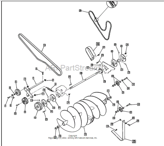

tonyvaughn 3 #1 Posted November 13, 2016 Hello, I have a 1974 C-160 automatic with a 42ST01 snow blower that I am in the process of rebuilding. Had to use a torch to remove both outer shaft bearings and tooth sprocket which I am going to replace? My question is are both outer bearings the same or do they have a different part number, also is there anything special about the pulleys, I would like to purchase all new pulleys, sprockets and chain. Any part numbers or places to purchase these items would be much appreciated other then Toro. Thanks 1 Share this post Link to post Share on other sites

rmaynard 16,888 #5 Posted November 13, 2016 Tony, This is your neighbor over on Chapel Road. Look at the diagram below and point out which parts you need. Bob Even though you have been a member since 2013, with this being your 1st post, let me be the first to say Share this post Link to post Share on other sites

tonyvaughn 3 #10 Posted November 14, 2016 Thanks to all for the great information, this is actually my first time sending in a request for some help on this forum. What a great resource to have, Bob I will give you a shout or stop by over the next couple weekends. Tied up this coming weekend. I am looking for all (3) pulleys, chain sprocket, bearings on both ends of the shaft and a chain, I did read your post Bob which seems much more cost effective. Talk to you soon. 2 Share this post Link to post Share on other sites
