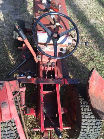

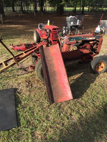

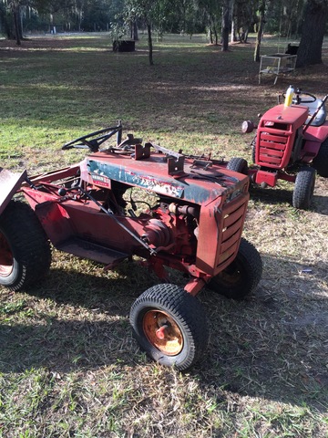

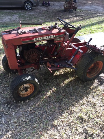

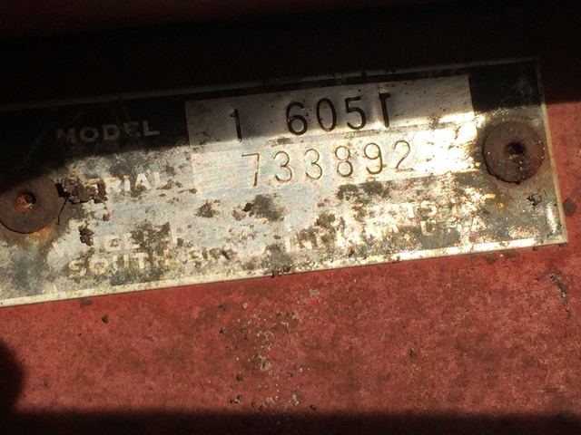

FrKsHwZ 15 #1 Posted November 11, 2016 Just became a SUPPORTER..! Well I feel Finally dragged it home and now trying to decide what to do with it. Definitely leaning towards parting it out or sell it all together, or keep it if the Wife say I can...lol. Idk yet. Like I said before got it all for $75. Working on the plow right now, but I did try to get the Clevis Hitch off, with no luck so far. After all that going to clean up the deck and make sure everything is lubed up " that's what she said." Well enjoy..! 6 Share this post Link to post Share on other sites
JimD 3,347 #2 Posted November 11, 2016 If you can get that engine to run this could easily be turned into a nice worker. Some pressure washing and a bit of touch up, nothing too extreme but a refresh would make her presentable. It has possibilities. 2 Share this post Link to post Share on other sites
FrKsHwZ 15 #3 Posted November 11, 2016 Unfortunately there's no compression in the engine(Tecumseh), I do have a extra running K241 generator start, was thinking about swapping it out it I did decide to keep it. 1 Share this post Link to post Share on other sites
Pollack Pete 2,273 #4 Posted November 11, 2016 9 minutes ago, FrKsHwZ said: Unfortunately there's no compression in the engine(Tecumseh), I do have a extra running K241 generator start, was thinking about swapping it out it I did decide to keep it. Pull the head..........probably just a valve stuck open.Easy fix. Share this post Link to post Share on other sites

CTPhil 53 #8 Posted November 17, 2016 On 11/11/2016 at 6:05 PM, FrKsHwZ said: Unfortunately there's no compression in the engine(Tecumseh), I do have a extra running K241 generator start, was thinking about swapping it out it I did decide to keep it. In the last week I'm 2 for 2 freeing hung valves in Kohlers by pouring ATF down the spark plug hole and letting them sit a couple of hours. 3 Share this post Link to post Share on other sites
