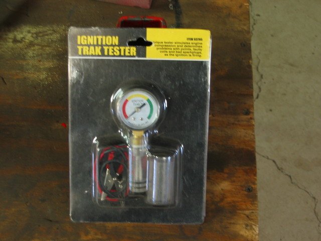

gwest_ca-(File Mod) 12,060 #7 Posted November 11, 2016 Years ago most service stations/garages had a Champion cabinet on the wall. There was an electrical cord to power a coil and an air line to a regulator that added air pressure to a cylinder the plug was threaded into. The air line also supplied an on-board sand blaster to clean the plug. To test the plug one threaded it into the cylinder that has a glass window and a mirror. Push a button and the coil would fire the plug which you could watch in the window and mirror. Then you cranked up the air pressure to see if the plug would fire under pressure. A used plug would eventually quit firing but forget what pressure was considered acceptable. The air gauge also had the poor, fair and good band on it's face. Garry 1 Share this post Link to post Share on other sites
wera512 9 #8 Posted November 11, 2016 It had a Bosch plug,but I think it was the wrong plug.It did run with it when I bought it. Share this post Link to post Share on other sites
pfrederi 20,047 #9 Posted November 11, 2016 14 hours ago, gwest_ca said: Years ago most service stations/garages had a Champion cabinet on the wall. There was an electrical cord to power a coil and an air line to a regulator that added air pressure to a cylinder the plug was threaded into. The air line also supplied an on-board sand blaster to clean the plug. To test the plug one threaded it into the cylinder that has a glass window and a mirror. Push a button and the coil would fire the plug which you could watch in the window and mirror. Then you cranked up the air pressure to see if the plug would fire under pressure. A used plug would eventually quit firing but forget what pressure was considered acceptable. The air gauge also had the poor, fair and good band on it's face. Garry You can buy the home version today... Share this post Link to post Share on other sites
ztnoo 2,302 #10 Posted November 11, 2016 Paul, Please tell us more about this test device! I assume perhaps you have one??? I'm glued to the screen waiting. Share this post Link to post Share on other sites
