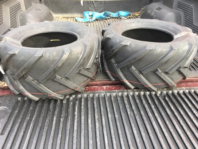

T-Mo-(Moderator) 4,753 #1 Posted November 7, 2016 10% discount at TSC. I had two sets of these tires already and those sets have been pretty good. So I bought these yesterday and they will go onto my 416-8. With work and the sunny setting earlier, especially since DST has ended, it might be a few days of pictures of these mounted on the tractor. 10 Share this post Link to post Share on other sites

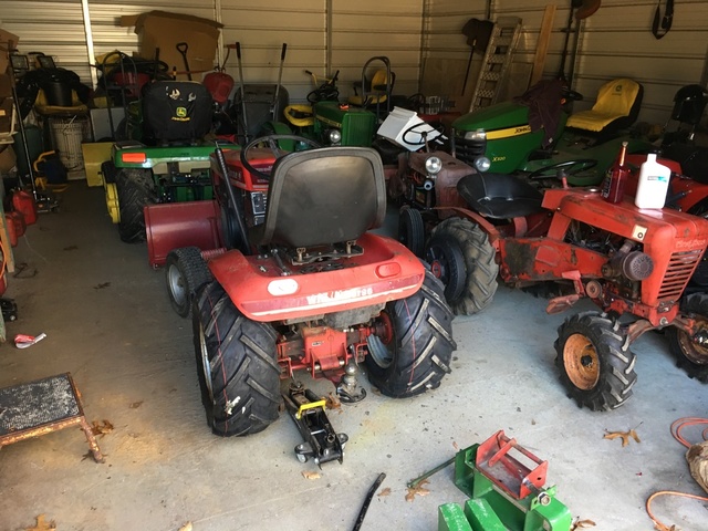

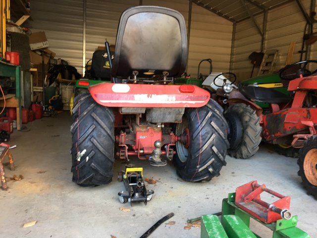

T-Mo-(Moderator) 4,753 #3 Posted November 12, 2016 Pictures of new tires mounted and on tractor. Afterwards I went out and smooth out the top part of the driveway near the highway with this setup. I normally use my JD GX345 for that, but I had to make the 416 earn the new tires. 6 Share this post Link to post Share on other sites

T-Mo-(Moderator) 4,753 #6 Posted November 12, 2016 9 minutes ago, Sparky said: What brand tire? Mike.... Hi-Run 23 x 10.5 x 12. Bought from TSC. From my research when I bought my first set of Hi-Runs a few years back from TSC, Hi-Runs are made in New Zealand from old Carlisle tire molds. I'm not sure if all of them are made from those molds, but I had good success with Hi-Runs so far. This is my third set of them. My JD GX345, that you can see in front of the 416, has a set of them. And I have been to two different plow days with these tires without issue. I also had a set on my JD 316 Onan and that tractor has been to a few plow days with Hi-Runs on it. They're not the best, but for the price, they do okay. 2 Share this post Link to post Share on other sites
Wheel-N-It 2,978 #7 Posted November 13, 2016 I sure like how those tires look T-Mo. So are they mounted on the stock 416 wheel? Not the wider 520 wheel? Reason I'm asking is for guidance on future tire purchases. If the 10.5 tires mount up no problem to the narrower wheel then I'll go with the 10.5 for my next tire upgrade over the 8.5 AG's. 2 Share this post Link to post Share on other sites
T-Mo-(Moderator) 4,753 #8 Posted November 13, 2016 16 minutes ago, Wheel-N-It said: I sure like how those tires look T-Mo. So are they mounted on the stock 416 wheel? Not the wider 520 wheel? Reason I'm asking is for guidance on future tire purchases. If the 10.5 tires mount up no problem to the narrower wheel then I'll go with the 10.5 for my next tire upgrade over the 8.5 AG's. Yes, they're mounted onto the stock 416 rims. And I still have about an inch gap between the tires and the seat mounting bracket (which is the closest thing to the tires). They seem to be taller than the 23 x 9.50 turf tires that were original to the tractor, so they are a bit closer to the fender deck, but still have enough clearance. 3 Share this post Link to post Share on other sites
