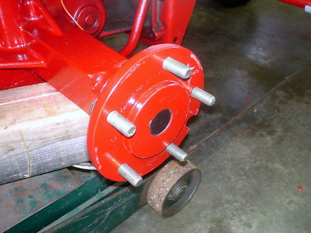

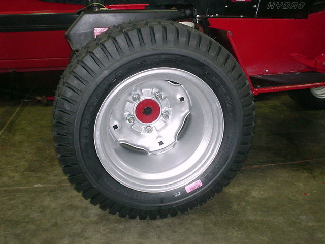

cleat 8,867 #5 Posted November 6, 2016 (edited) The 1100 rear end is wide enough that the hubs being flush and up against the axle housing is one and the same. Here are 2 pics showing my 520 with the smaller wheels and tires just as you have. Edited November 6, 2016 by cleat 4 Share this post Link to post Share on other sites
Jerry77 1,218 #6 Posted November 6, 2016 6 minutes ago, Racinbob said: Are the axles flush with the outside of the hub Yeah, they are...what are you thinking? 1 minute ago, 953 nut said: Have you considered using a spacer on that side? No, I had not thought of that,,, that would be a simple solution - shouldn't affect anything should it? I have some 3/8 steel that I could fabricate for that - good Idea ! 1 minute ago, cleat said: The 1100 rear end is wide enough that the hubs being flush and up against the axle housing is one and the same Cleat - your picture shows about 1/4 inch or so of projection - mine are flush...?? also, I see the head of the bolt on the backside of yours - mine are threaded holes - the 1100 I have is from a 418A..Did they make them different at times???. Thanks everybody... 1 Share this post Link to post Share on other sites
cleat 8,867 #7 Posted November 6, 2016 Mine are pretty close to flush on all 4 machines. I use bolts threaded in to be able to use regular lug nuts. Makes changing wheels so much easier, especially if they are loaded with liquid ballast. So far as I know, all the Eaton 1100's were the same size. 3 Share this post Link to post Share on other sites
