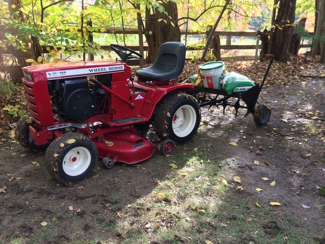

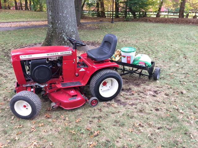

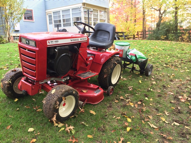

Al C. 1,429 #1 Posted November 2, 2016 November 3rd ... can't believe the weather in northeast Ohio! Should be snowing. 78 degrees and sunny! Haven't even had a frost. Nothing like aerating in sneakers and shorts three weeks before Thanksgiving. 18 Share this post Link to post Share on other sites

JimD 3,347 #17 Posted November 3, 2016 Al, that's a dandy SK-486 you have there, and yes the weather has been great. But I have a question about your tractor. There is a bar with a bend in it just below the engine and it has a small pulley on the end of it. I have never seen this before and would like to know what it is for. Is this a home made device with some specific purpose? Now don't make fun of me guys, I'm trying to learn something here. I've seen a lot of things on our machines that I didn't know the purpose of but I haven't seen everything. 5 Share this post Link to post Share on other sites
WHX?? 55,098 #18 Posted November 3, 2016 (edited) 25 minutes ago, JimD said: Now don't make fun of me guys We would never do that Jimmy D but whatsamatta wich you.......that is obviously an attachment for help in restringing his wife's clothes line poles... even an idiot like me can see that!! Edited November 3, 2016 by WHX8 6 Share this post Link to post Share on other sites
JimD 3,347 #19 Posted November 3, 2016 2 minutes ago, WHX8 said: We would never do that Jimmy D but whatsamatta wich you.......that is obviously an attachment for help in restringing his wife's clothes line poles... even an idiot like me can see that!! Well, your explanation is better than mine. I thought it was for when Lassie came home barking for us to follow her, we could use it to drop a line for Timmy, who is down the well again. 6 Share this post Link to post Share on other sites
elcamino/wheelhorse 9,363 #20 Posted November 3, 2016 I was wondering about the piece also , but could not figure it out. Share this post Link to post Share on other sites
TDF5G 2,073 #21 Posted November 3, 2016 (edited) I noticed the bracket below the engine also. I'm going to guess it's to run a rope through to operate a tow behind implement. Maybe a spreader or something. Also looks like you might tie a rope to hand operate the pedal. ?? Edited November 3, 2016 by TDF5G 3 Share this post Link to post Share on other sites

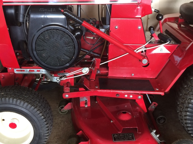

Al C. 1,429 #22 Posted November 3, 2016 Ok guys, you got me. I have bad ankles ... flat feet, tendonitis, will require surgery some day. There are days when it hurts too badly to fully depress the clutch pedal. On those days, the bracket below the engine is one end of a double pulley I attach to the clutch pedal. I thread a rope with a handle through the pulleys and before you know it I have a hand-clutch. Not pretty, but it works! I guess if the rope is long enough, my wife could use it as a tensioner on her clothes line !!! 13 Share this post Link to post Share on other sites
ClassicTractorProfessor 5,455 #23 Posted November 3, 2016 Good innovative thinking Al...never would've thought of it but it works that's the main thing 4 Share this post Link to post Share on other sites
Ed Kennell 44,955 #24 Posted November 3, 2016 (edited) WOW , the ingenuity of the owners never ceases to amaze me. Time for a HYDRO ? Edited November 3, 2016 by Ed Kennell 6 Share this post Link to post Share on other sites
Upper Canada 213 #25 Posted November 4, 2016 Your hand clutch system is just like a , it is simple mechanics but yet gets the job done. I like what you did and will keep it in mind as I have bad knees and they are only going to get worse as I age. 2 Share this post Link to post Share on other sites
