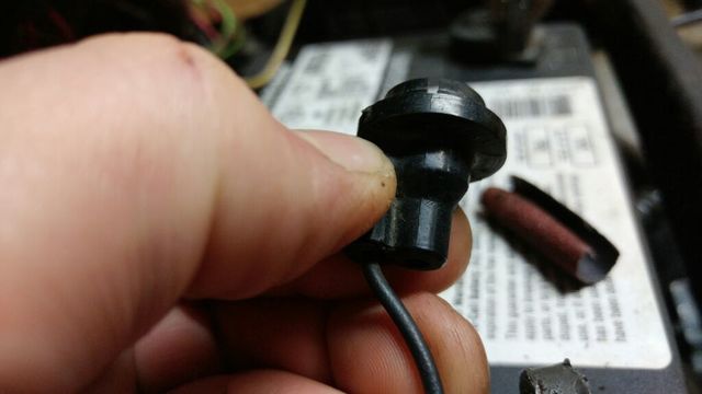

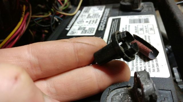

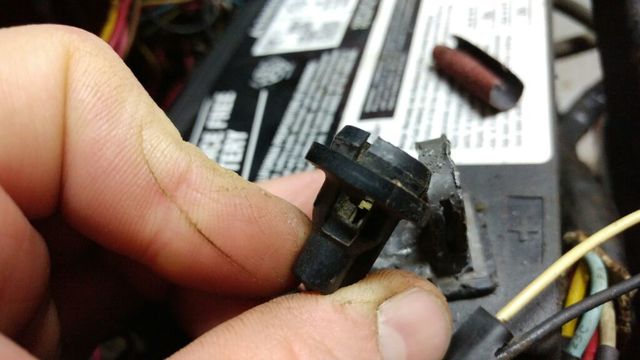

Duramax7man7 506 #1 Posted November 1, 2016 (edited) Hey Gang, Was wondering if anyone knew a good replacement for these gauge lamp sockets? They are 2 wire, 12v push in types with about 1/2" diameter or so. It would be nice to move to LED bulbs as well for a bit of a modern touch. The contacts are pretty worn out as are the tension springs. One is missing. I've tried a few places and it looks like I would have to get a completely new wiring harness or find some that match somehow. I figured I'd also ask here to see if anyone has dabbled with this? Thanks in advance. Andrew C. This is what is currently on the gauges. Edited November 1, 2016 by Mastiffman Share this post Link to post Share on other sites

darren 49 #10 Posted March 24, 2018 (edited) Hi Andrew, I've just been looking to do the same upgrade on my 520. For what it's worth, the bulb 'type' used by these sockets is the 233 T4W. It's possible to get LED variants (that's what I've done) - the other option is to replace both bulbs and holders for the 'wedge' type that seem to have become more popular. That's probably the best option if you're even slightly handy with a soldering iron, as I imagine it's easiest to chop and replace the old holders even if you're going like for like. I appreciate this answer is probably a bit late! All the best Darren Edited March 24, 2018 by darren Share this post Link to post Share on other sites
