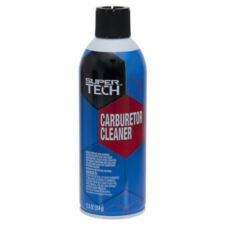

r356c 375 #13 Posted October 29, 2016 This Walmart product has resurrected two carbs for me this season with minimal disassembly. It is a good idea to wear safety glasses when clearing all the fuel passages clogged with ethanol gas funk. 1 Share this post Link to post Share on other sites
