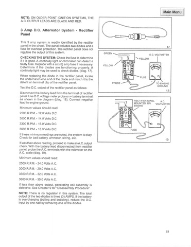

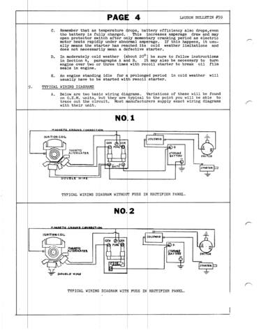

formariz 12,379 #7 Posted October 30, 2016 (edited) Should be a 6 AMP fuse. Here is everything related to it. In your case since you have a fuse it should be schematic #2 in service bulletin 4. Edited October 31, 2016 by formariz Share this post Link to post Share on other sites
