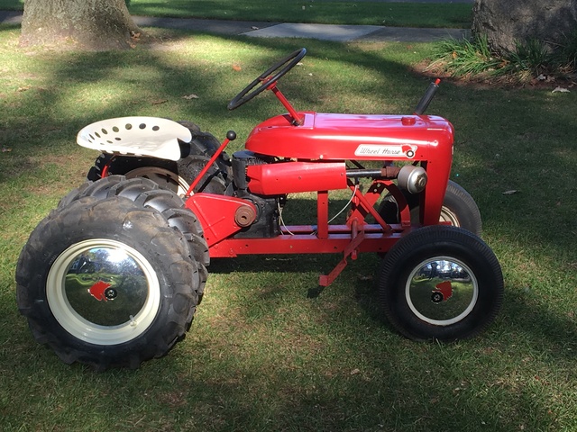

Dhodge 528 #1 Posted October 25, 2016 Found some ag tires and rims at a old gas tractor show. I blasted and painted the rims and mounted them on this little guy. I kinda like the look. I'm gonna need a new place to house it though because she will no longer fit through the shed door. 16 Share this post Link to post Share on other sites

AMC RULES 37,254 #9 Posted October 25, 2016 Nice, but your adapters are way too wide. You can expect to see those axle seals to start leaking soon... if they're not already. 1 Share this post Link to post Share on other sites

Dhodge 528 #11 Posted October 25, 2016 1 hour ago, AMC RULES said: Nice, but your adapters are way too wide. You can expect to see those axle seals to start leaking soon... if they're not already. I know my adapters are for the larger 400 and 500 series tractors. I need to make a pair for this little guy, but I did not know that would make the axle seals leak. Maybe I should take them off. They are not leaking because I just put them on Sunday. Thanks for the heads up 1 Share this post Link to post Share on other sites
