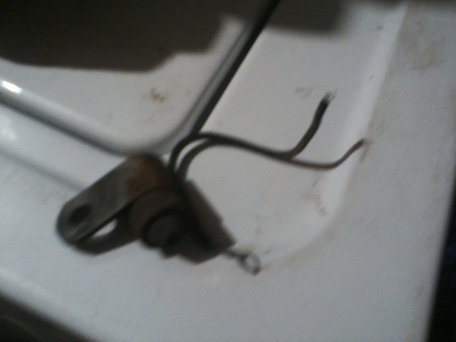

Elkskin's mower junkyard 1,117 #1 Posted October 21, 2016 well my work horse gt-1642 is almost done. finished my rewiring and ended up playing check around on solenoids trying to find a good used one. well i did the one off the c125 lol. ended up swapping voltage regulators didnt like looks of one off the c125 so i used the one off the parts b80. got wiring all done and got machine to fire but wasnt running right. backfiring like crazy wouldnt idle and wouldnt even rev up acted like you turned the key off. so i swapped carbs no change. so i got on google and doing some searching couldnt find much. then it hit me what the issue could be. ill just let this picture do the talking. had a jd 214 come in last year at mower junkyard with same symptoms which we fixed and customer was happy. so i put a used condensor on fired the 12hp kohler up ran great. 4 Share this post Link to post Share on other sites
