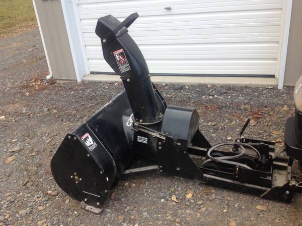

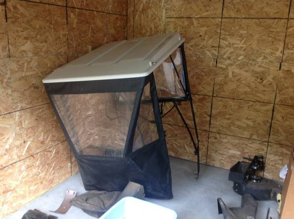

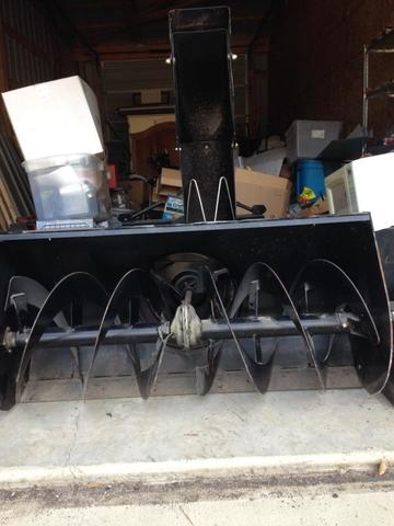

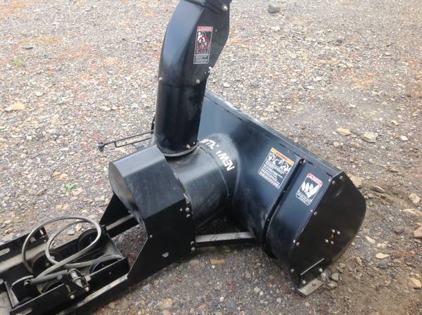

JERSEYHAWG / Glenn 4,589 #76 Posted October 23, 2016 46 minutes ago, WHX8 said: Glenn...you'very got yourself a cab...much less frustrating I have been very busy lately, but just for you, I got something PLUS a cab. Have a look see. It came off an 80 hour machine. Hope you like it, I do. Finally, will be snow blowing in style on the 522xi. Glenn 9 Share this post Link to post Share on other sites

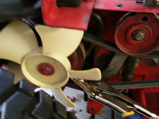

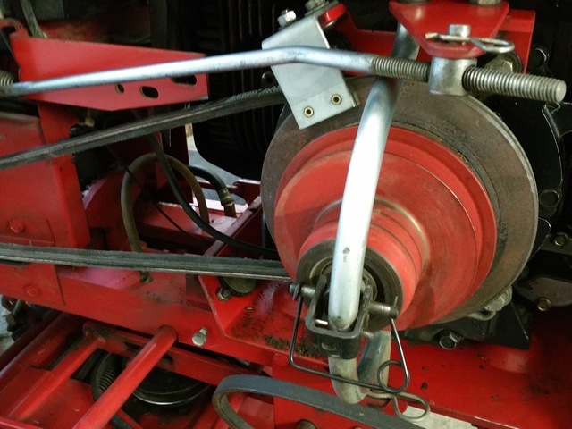

squonk 48,051 #79 Posted October 23, 2016 With that blower and cab you've gone and done it. You won't have any snow this winter. Hey, it worked for me last year! On 10/18/2016 at 8:37 PM, shallowwatersailor said: I seem to recall that Wheel Horse used a different profile belt than what was standard. I've had good luck with replacement Toro belts. Back to my commercial HVAC days, belts could dryout hanging on the rack. I'm talking belts that were 12 feet in diameter in groups of four - plus 40 years ago technology. NAPA 5L830W belt As far as WH/Toro using a different profile belt, I keep seeing this on the forum but never any documented proof. Out side of a few oddball applications, I can't believe as frugal minded as the boys at WH were, I can't believe that they spec'd special pullies and special belts for their tractors. I've used Napa and TSC belts for years without 1 issue. I even had a TSC belt work better than a brand new Toro belt on one tractor. 2 Share this post Link to post Share on other sites
Sarge 3,473 #80 Posted October 23, 2016 If you look at the older belt specs , all the WH belts were HA profile which is indeed different than the common A profile belt . Over time , using A belts on the older equipment will wear out the pulleys towards the center - my 1277's engine pulley finally got too far worn and would eat a new belt pretty quickly from slippage . I got the belt angles off the net somewhere , welded up the pulley with the tig and ER80SD2 rod and re-turned the profile in the lathe ... Sarge 2 Share this post Link to post Share on other sites

squonk 48,051 #83 Posted October 23, 2016 (edited) Right from Q Power belts: HA, HB, and HC belts are dimensionally similar to A, B, and C industrial belts described in Rubber Manufacturers Association standard IP-20. However, the constructions differ in tensile members, cord placement, compounds, and fabric in the case of wrapped belts. In addition to our Q–Power® V–Belts we also manufacture the classical A, B, and C industrial belts that are built to Rubber Manufacturers Association specifications. So according to them, HA belts were different in materials NOT in size dimensions. Also over tome, pulleys wear out no matter what belt is used. Edited October 23, 2016 by squonk 2 Share this post Link to post Share on other sites

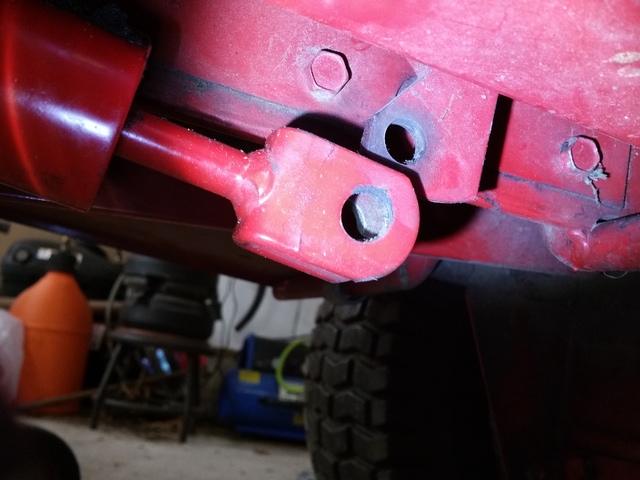

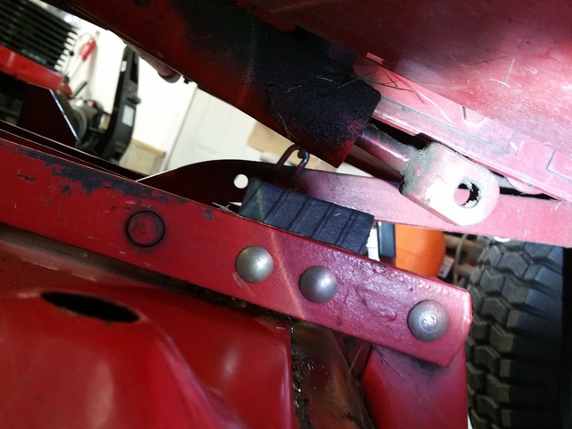

JERSEYHAWG / Glenn 4,589 #96 Posted November 1, 2016 sarge. I put on a genuine toro drive belt. 90 percent of the time I have bought the genuine belt. although I DO have snoblower spares from other manufacturers. I did not want to chance it on the main belt for a few dollar savings. BTW fellas, its running great.... I need a little help here. cant find it in the manual. but I noticed taking the deck off that the lift piston was connected to nothing, when I reached up and found out the attachment point. there is no attachment pin..bolt..clevis and pin.....I put a picture of the 2 attachment points. What exactly attaches them, I am guessing a pin and clevis????? Do any of you fellas know the correct part number? BIG THANKS also, dropping the trans fluid right now I have no idea what this guy has in there,,,,,some home made concoction. this blackhood is really growing on me. Glenn 7 Share this post Link to post Share on other sites
gwest_ca-(File Mod) 12,483 #97 Posted November 1, 2016 Here is an original parts list for this tractor Go to Part 2 of the download Cylinder and pin on page 44 of the manual which is Page 14 of the file. Clevis pin 932997 1/2" x 1-1/4" Cotter pin 932017 1/8" x 1" Garry 2 Share this post Link to post Share on other sites
