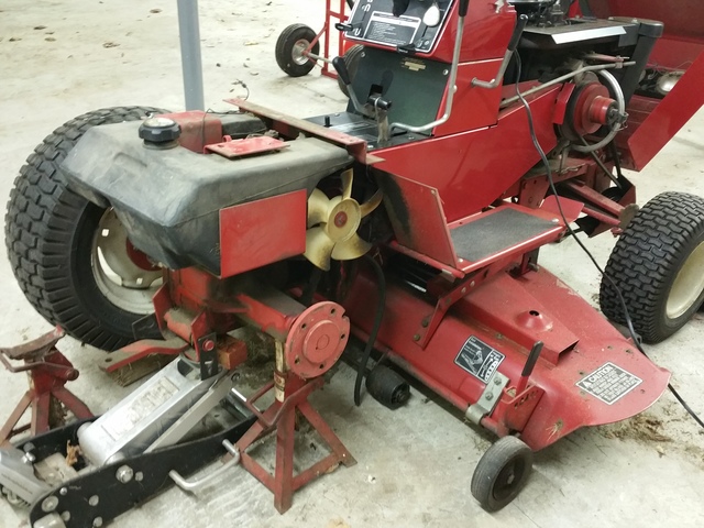

JERSEYHAWG / Glenn 4,589 #53 Posted October 19, 2016 (edited) The culprit, still in the garage working. retirement is grand. Glenn thank you JD. maybe I better post in the want ads....who has a metal pan? lol Edited October 19, 2016 by JERSEYHAWG / Glenn 3 Share this post Link to post Share on other sites
jdleach 525 #54 Posted October 19, 2016 There are piles of those seats out the Glenn. Saw stacks of them at Mentone earlier this year. 1 Share this post Link to post Share on other sites

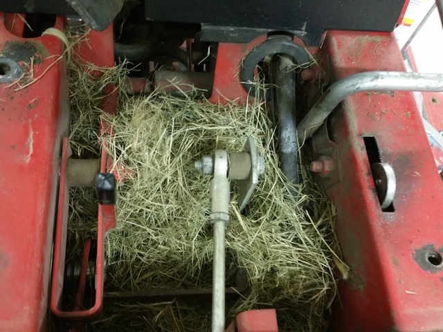

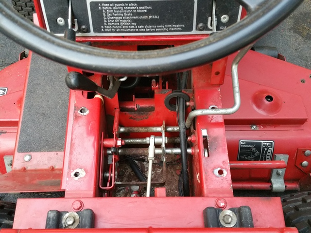

JERSEYHAWG / Glenn 4,589 #55 Posted October 19, 2016 under the hydro / brake control plate. I am done for the night. Glenn 5 Share this post Link to post Share on other sites
AMC RULES 37,259 #56 Posted October 19, 2016 That's just provenance Glenn... proof it not only looks good, but works hard for it's living too. 1 Share this post Link to post Share on other sites

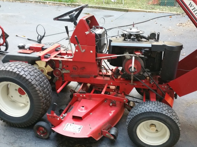

Wheel-N-It 2,978 #57 Posted October 19, 2016 Good looking C175 Glenn! Regarding the loose regulator, is the battery getting a proper charge? If not, remove the plug from the regulator and check the voltage at the center female terminal. You should have 12vdc there with the engine running. The 12volts there comes straight off the ignition switch. Also if the engine is rubber mounted I recommend adding a grounding jumper wire from one if the regulator mounting bolts to the negative post on the battery. If you can't get your hands on a metal seat pan any time soon, I can bring you one to the Big Show next year. Enjoy! 2 Share this post Link to post Share on other sites
