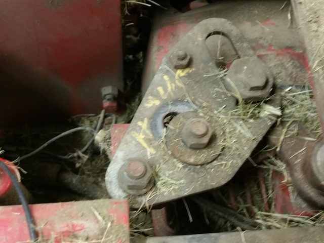

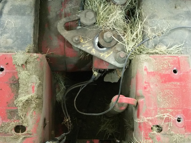

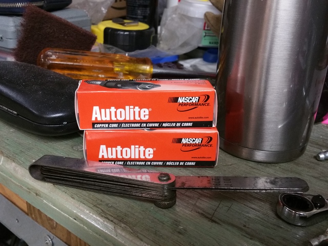

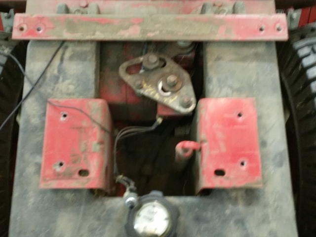

JERSEYHAWG / Glenn 4,590 #28 Posted October 18, 2016 (edited) 1 hour ago, slammer302 said: In the pic the bolt looks loose the voltage regulator has to be grounded or they will spark had the same problem on the city's wheel horse. I do have a series one Kohler parts engine if you need anything let me know and I can see if I have it. slammer, you have good eyes. on closer inspection, both bolts were very loose. I backed them out, checked threads for cross threading, a drop of oil. tightened them in like they are supposed to be. suprise. no sparks flying from under the cover. thanks. Glenn 2 hours ago, Jerry77 said: I can honestly say, in my 60 + years of driving I have never had a Champion spark plug that was worth two cents............ pfredi, jerry and all autolite fans. I just got back from getting 2 autolite plugs. I was told / warned. what I took out was a no go. so 2 plugs (champions) at 9 bucks are being replaced after this post with 2 autolites at 4 and change per the pair.these should be way better. thanks for the tip guys. Glenn 3 hours ago, gwest_ca said: Transmission drive belt 108502 - (HB/5L x 83" or 5/8" x 83") Garry Garry, thank you sir for the belt number, I did a flea bay search, found a few NOS, from 30 plus shipping down to 25. Would anyone run a differant cheaper belt? If so which one? Or stick with NOS? just asking, thanks so far guys on the advice, help, and comments. I am in the garage right now getting down and dirty. lordy I luv this kind of fun. Glenn Edited October 18, 2016 by JERSEYHAWG / Glenn picture 6 Share this post Link to post Share on other sites

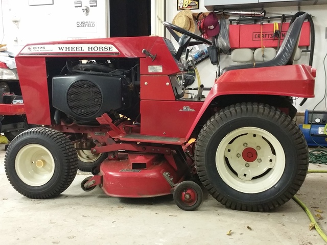

Kurt-NEPA 756 #29 Posted October 18, 2016 Good looking Horse Glenn. You'll get the little bugs worked out. Kurt 1 Share this post Link to post Share on other sites
KC9KAS 4,746 #30 Posted October 18, 2016 (edited) WOW, very nice tractor and I don't go for the black hoods. Glad you got a great deal. Edited October 19, 2016 by KC9KAS spelling 1 Share this post Link to post Share on other sites
Wishin4a416 2,610 #31 Posted October 18, 2016 That is a nice looking Horse Glenn. Remember one nice thing about this hobby is there is no deadline. You can work on it some and then walk away and collect your thoughts. Take your time and Im sure you will get the bugs worked out. 6 Share this post Link to post Share on other sites
AMC RULES 37,260 #32 Posted October 18, 2016 When you've had enough of poking that pig... just let me know Glenn. 1 Share this post Link to post Share on other sites
DennisThornton 4,773 #33 Posted October 18, 2016 Don't know what you paid for it but like Craig just said, I'm thinking someone will offer to buy it from you! Looks good to me! 1 Share this post Link to post Share on other sites

JERSEYHAWG / Glenn 4,590 #43 Posted October 19, 2016 1 minute ago, ACman said: Glen I hope it all works out in the end . As far as spark plugs go for me it's Autolite , ACdelco , of NGK's depending on application . That is one one nice looking black hood ! thank you Jeff, the autolites made a big differance to. Glenn 2 Share this post Link to post Share on other sites
slammer302 2,157 #44 Posted October 19, 2016 When it comes to spark plugs I'm a big fan of NGK's. 4 Share this post Link to post Share on other sites

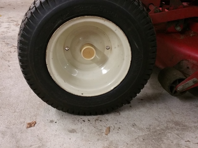

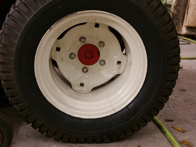

JERSEYHAWG / Glenn 4,590 #47 Posted October 19, 2016 3 hours ago, slammer302 said: Even though it's a basket case it looks good. half a basket....... a wipe down on the rims for kicks. Glenn 11 Share this post Link to post Share on other sites

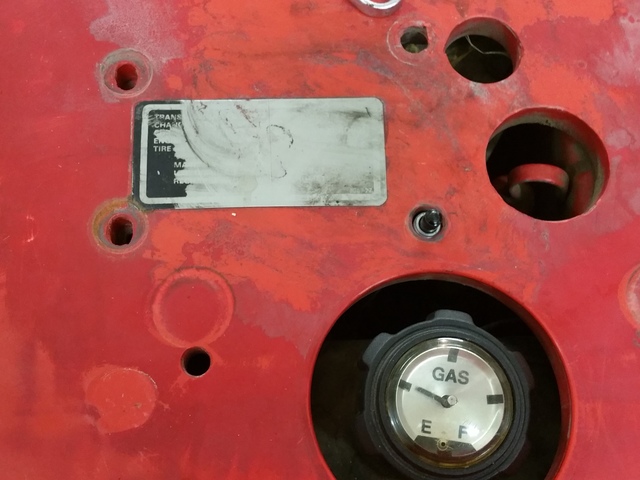

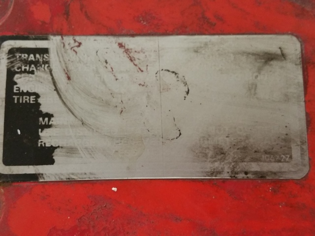

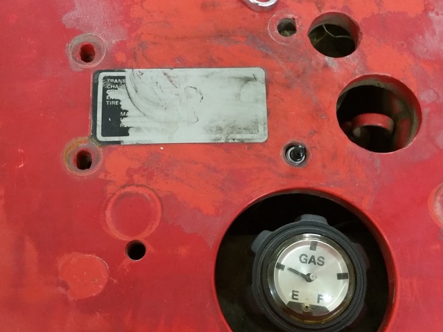

JERSEYHAWG / Glenn 4,590 #49 Posted October 19, 2016 the birth certificate. who can read it? he must have cleaned it with jet fuel, a plastic sticker is all. Glenn 1 Share this post Link to post Share on other sites

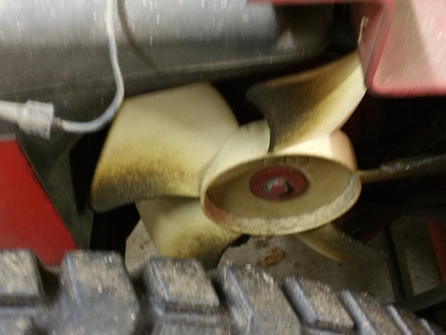

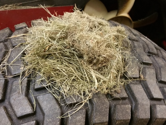

JERSEYHAWG / Glenn 4,590 #50 Posted October 19, 2016 the packs of grass you always find. the fan blades are all there and intact. Glenn . oh, amazing that the plastic pan is intact 100 percent. would you guys save that and install a metal pan? 2 Share this post Link to post Share on other sites
