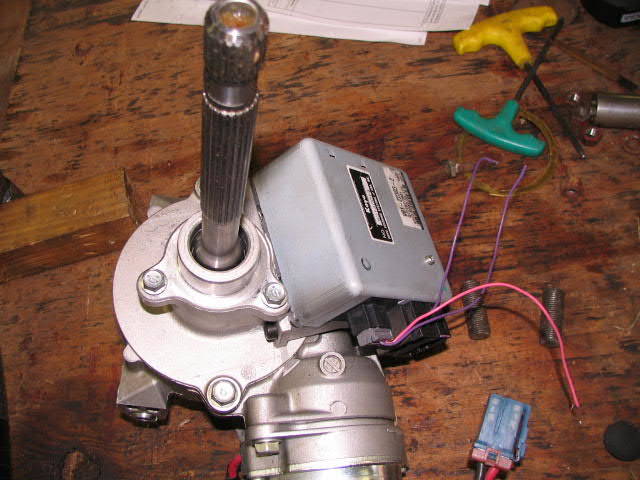

pacer 3,179 #1 Posted October 17, 2016 (edited) Power steering for the big D's have been kicked around quite a bit but I haven seen any thing about trying one of the - many - variations of electric types. A bit of background - I have a 4x4 Mitsubishi with loader and whoa! the steering on it with a load is really tough! so I was prowling around on the web and was seeing the many uses guys are coming up using these things (dune buggies, kit cars, older cars, etc) Seems the favorite is a unit off the 02-07 Saturn Vues. Looking at My D's steering I'm beginning to wonder/think that I might be able to stuff one of these under the dash?? Anybody looked at these things?? Edited October 18, 2016 by pacer 1 Share this post Link to post Share on other sites

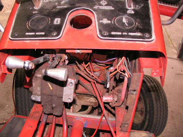

82Caddy 851 #4 Posted October 18, 2016 I'm not sure where you'd put that... Are you thinking down low where the box is now with some joints and another column or up high by the dash? Its tight to begin with where the steering column, hydro pump and lines all are. I have a 5 port JD column on my d series. Works great. Had to bend a few pieces of metal to mount it. Wasn't bad and works great. Share this post Link to post Share on other sites

pacer 3,179 #15 Posted November 1, 2016 Update on the "D" power steer---- The EPS (electric powersteer system?) came in finally (slow ship) I believe it would fit ..... but - (theres that 'but')... the spool valve is in the way. If it wasnt hard line plumbed and could be easily moved over about an inch then likely would work. I dont want to go that far modifying my D! Notice the rounded part under the shaft, the spool valve is in the way of that part - you can pretty well see the relation of the valve and the steering shaft hole where it would have to go and its just too close. The EPS would have to go where the battery sits, but that likely wouldnt be too big a problem. Next I'll have to get the Mitsubishi in the shop and see if it WONT work on it either! 2 Share this post Link to post Share on other sites
