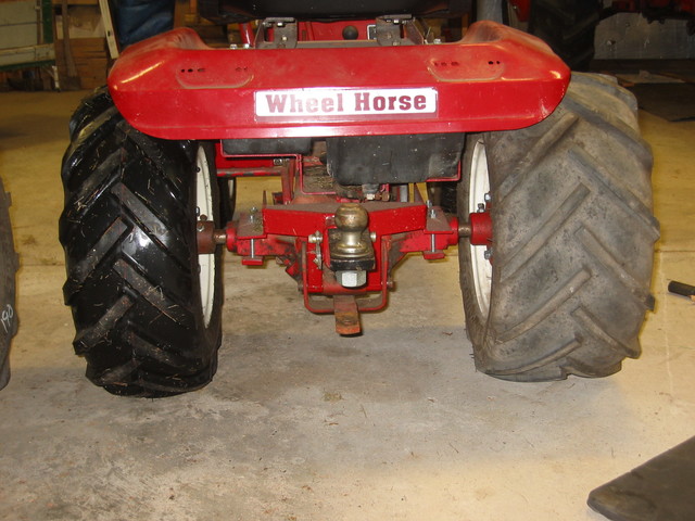

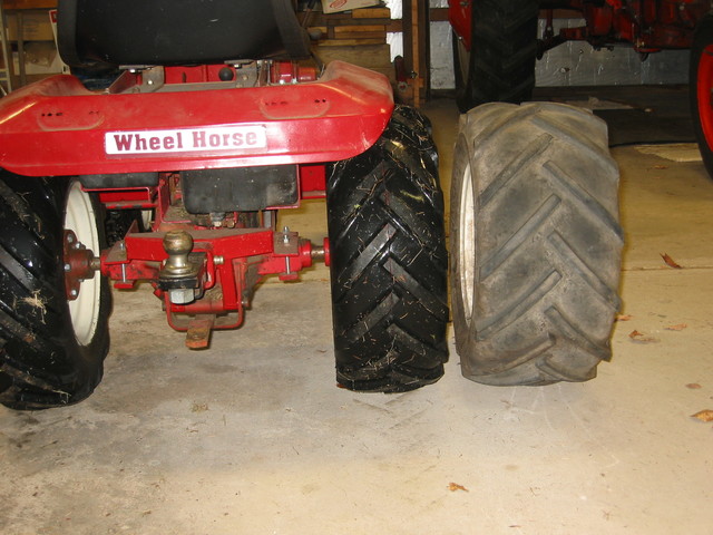

pfrederi 21,306 #6 Posted October 18, 2016 As I said different brands are diffet in sizing. Both of these a 23 x 10.50 x12 Deestones (small) Carlisle (bigger) If you do not have a paved driveway turfs and chains are better than ags. especially for snowblowing. If you have to back up AGs do not do well and if you have to raise the blower taking weight of the back they are even worse. 2 Share this post Link to post Share on other sites
