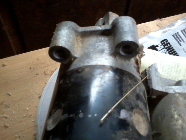

WH nut 553 #1 Posted October 13, 2016 Is there a way to shim or adjust the starter on a P220. It sounds like hell when engaged and the motor kicks back when it fires like the timing is advanced. I have already broken one nose already and chewed up one ring gear. Its the right starter and I see no way to adjust in or out to make it mesh better. Share this post Link to post Share on other sites

slammer302 2,156 #4 Posted October 13, 2016 I just worked on my uncle's p218 and had to add a washer between the starter and block it helped alot. The original flywheel ended up being trashed bought another and had starter rebuilt Share this post Link to post Share on other sites
WH nut 553 #5 Posted October 13, 2016 4 hours ago, slammer302 said: I just worked on my uncle's p218 and had to add a washer between the starter and block it helped alot. The original flywheel ended up being trashed bought another and had starter rebuilt So you moved the starter in towards the flywheel? And did you add the washer to both bolts or just one? Share this post Link to post Share on other sites
slammer302 2,156 #6 Posted October 13, 2016 I only added the washer to the top hole and yes I believe it did move it in. On this particular engine something wasn't right. The mounting hole through the block for the starter was cracked so that's the one I added the washer too. It made a big difference in my experience. May not in someone else's situation. Share this post Link to post Share on other sites
WH nut 553 #7 Posted October 14, 2016 38 minutes ago, slammer302 said: I only added the washer to the top hole and yes I believe it did move it in. On this particular engine something wasn't right. The mounting hole through the block for the starter was cracked so that's the one I added the washer too. It made a big difference in my experience. May not in someone else's situation. This one, the P218, and my P220 has the holes straight across the top. By looking at the drive the starter needs to move away from the ring gear Share this post Link to post Share on other sites
Duramax7man7 506 #8 Posted October 15, 2016 I've noticed the same exact thing on my P220G-I/10955C on the 90' 520-H that I newly acquired and the 9 tooth pinion doesn't seem to match the 95 tooth 170-4039 Flywheel ring gear. The ring gear was all chewed up from the time I got it and it sounded horrible. I purchased another flywheel and I'm debating on what to do about the Starter... Boomer informed that the B series Onan 20hp motors didn't have the ring problems. Looking for a solution as well. Share this post Link to post Share on other sites
Duramax7man7 506 #9 Posted October 20, 2016 I just pulled the starter from my 41-20OE01 toro 520H. It had a 191-1949-04 Starter on it. I'm guessing this starter was a replacement as the parts diagrams all show 112-7023 for the starter. I too found a hairline crack on the bolt hole that is up against the cylinder. It's at the end which is closest to the flywheel. The crack is on the bottom of the hole closest to the starter. It's only about 5/8" to 3/4" long and when I put a bolt in that end of the hole and cranked on it, I couldn't see any movement at all. I purchased a new (use) flywheel and will be receiving a new (used) pinion gear from Boomer by the weekend. So hopefully the crack was from misalignment over the years from an old chewed up flywheel and will do great with a newer flywheel and pinion gear. If not, I will be replacing the starter and oil pan with a B43E, B48E or a B48G series Onan 20hp engine as I'm being informed that they didn't have the issues that the P series combo had... Share this post Link to post Share on other sites
