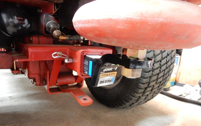

JERSEYHAWG / Glenn 4,590 #26 Posted October 14, 2016 1 hour ago, Kurt-NEPA said: Your setup seems to add as much weight as mine. I added a hitch and 100 lbs of barbell weights. I'm hoping that is enough. 150lbs of wheel weights, 100+ lbs of barbells and my 250+ should be enough. At least I hope so. We'll see. I hope you are right about climbing a tree Jeff. Kurt, can we see that hitch barbell weight set up please. The reason I ask is I have one of the vendor rear hitches I bought, I was trying to figure how to use it for rear weight. I do have 2,,70lb cast wheel weights for the rear tires. But considering the weight of the blower I knew I would need more weight to counter balance and offset it. Thanks. Glenn Share this post Link to post Share on other sites

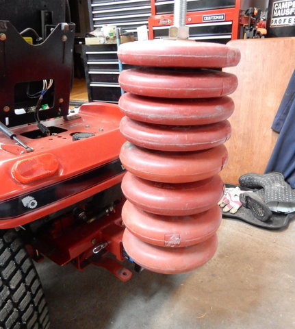

Kurt-NEPA 756 #27 Posted October 14, 2016 I did a real simple barbell weight hitch, Glenn. Sized to fit some weight I picked up from a neighbor for $20. The weights were only 10 and 15 pounders. I would rather have heavier cast iron weights, but that would require a hitch extension. I used 1" threaded rod and still have to cut off the excess. I'm going to test this on the first snowfall. Might make some modifications, maybe figure out how to add more weight if needed. 2 Share this post Link to post Share on other sites
JERSEYHAWG / Glenn 4,590 #28 Posted October 14, 2016 Very simple with the threaded rod, buy hey, it works. Thanks Kurt. Glenn Share this post Link to post Share on other sites
