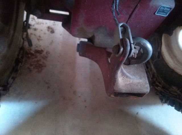

gt4 196 #1 Posted October 11, 2016 what would I need to hook up a one bottom plow to a 854 wheelhorse.I would like to get involved in the plow days and meet other members. Share this post Link to post Share on other sites
953 nut 62,349 #2 Posted October 11, 2016 A slot hitch will do the trick for most plows. 2 Share this post Link to post Share on other sites
T-Mo-(Moderator) 4,653 #3 Posted October 11, 2016 If your plow is a Brinly sleeve hitch type, then you need the clevis hitch, or the adapter to convert a slot hitch to a clevis hitch. 2 Share this post Link to post Share on other sites
