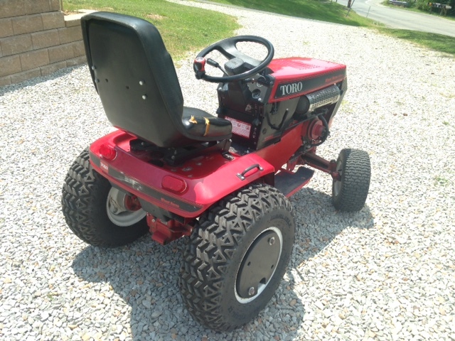

stratostar250 934 #2 Posted October 11, 2016 I recently picked up a 520 to put a 60" deck on, and I can't lie, there isn't much room around the tires, I have a feeling you'd maybe have issues turning with larger front tires, and larger rears are for sure going to be tight. Just went out and took a pic for ya. Hope this helps. 5 Share this post Link to post Share on other sites
fast88pu 3,372 #3 Posted October 11, 2016 OK thank you. The picture helps Would you happen to have a side view picture? Share this post Link to post Share on other sites

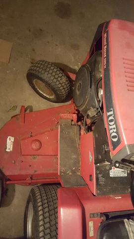

squonk 45,556 #4 Posted October 11, 2016 My 90 520 had 25 X 9.50 X 12 rear tires. The P.O. had shimmed the rear fender pan up about an inch. He also had some spacers to move the wheels out some. I cannot use this set up with a 42" RD deck so I took everything off. Tires with wheels will be for sale if interested. Here's a pic 3 Share this post Link to post Share on other sites

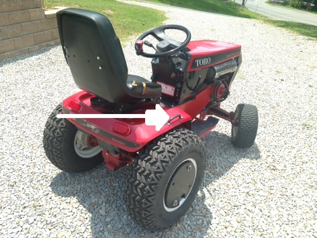

wallfish 19,333 #5 Posted October 11, 2016 What's up with the "OH $--t" handle? Gett'n old and having some trouble? 1 Share this post Link to post Share on other sites
TDF5G 2,073 #6 Posted October 11, 2016 I can't speak for the owner of this , but I can see a reason for that handle being there. When I mow the bank in front of my house I sit halfway on the fender and seat and I usually grab the fender there to kind of steady myself. A handle located on the fender there would probably be useful. 1 Share this post Link to post Share on other sites
squonk 45,556 #7 Posted October 11, 2016 Those "Love" Handles were on there when I got it. Since removed. 2 Share this post Link to post Share on other sites
JERSEYHAWG / Glenn 4,527 #8 Posted October 11, 2016 2 hours ago, squonk said: Those "Love" Handles were on there when I got it. Since removed. Mike, what kind of weights are those? They fill the space nice. Also, what do they weigh? Thanks Glenn 2 Share this post Link to post Share on other sites
squonk 45,556 #9 Posted October 12, 2016 Just solid weights. Not sure what they are made from exactly but they weigh 40 lbs apiece. I have them for sale in the classifeds Share this post Link to post Share on other sites
