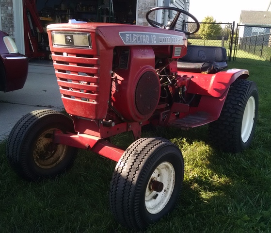

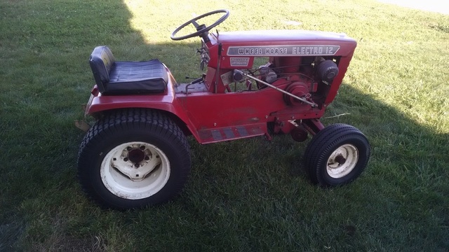

HoosierDude 4 #1 Posted October 10, 2016 Greetings. Wanted to share this Wheel Horse that's been in my family for quite a while. My dad remembers, as a kid, accompanying his grandfather to an auction where he purchased it. Probably sometime in the 70's near Fort Wayne, IN. It's been in the family ever since, and I guess now it's my time to look after it. Just trying to get her started up, she ran well as recently as last Summer, but I think the battery has given up the ghost. The one on the tractor right now is a John Deere StrongBox TY25221. Is that correct? Can anyone give me some direction in finding the proper battery? Also, I think I've got starter problems, as in the starter not always engaging the flywheel. I haven't even driven this thing in probably 10 years and so far all I've done is washed her off and put some wax on the hood, so please bear with me if I'm off to a rough start here. I do know a thing or two about cars and bikes. Thanks! 3 Share this post Link to post Share on other sites

Pollack Pete 2,273 #5 Posted October 10, 2016 VERY nice Electro 12.Looks to be a true survivor.Plus,it looks super clean.You can certainly tell a machine that's been in the same family for years.Have fun with your new toy. Share this post Link to post Share on other sites
