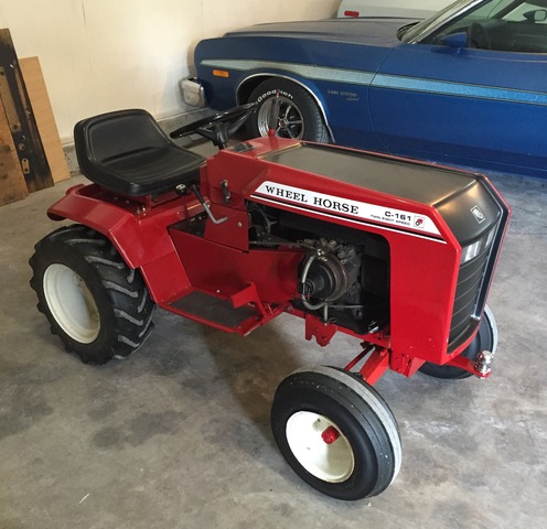

cschannuth 3,819 #5 Posted October 10, 2016 I use it to plow with no problem in hi range 2nd gear. It is a '78 C-161 with a Briggs twin. It sat in my dad's basement for 8 years. I got it out, cleaned it up, and got it running about 6 months ago. It's always been noticeable since I've been using it the last few months. I can't remember if it did this when I used to mow with it at home 35 years ago. After I didn't have any luck after I replaced the belt I took it to the Wheel Horse dealer where I bought the belt and they said all it needed was a clutch spring so I ordered one and installed it. Like I said above that seemed to help but it still seems to slip in high gear. My dad was a stickler so the tractor is in very good, original condition. I don't have any pics with the belt guard off but here is the tractor for reference. I added the larger rear tires with antifreeze in them. The tractor acted the same before and after the tire change. 1 Share this post Link to post Share on other sites
