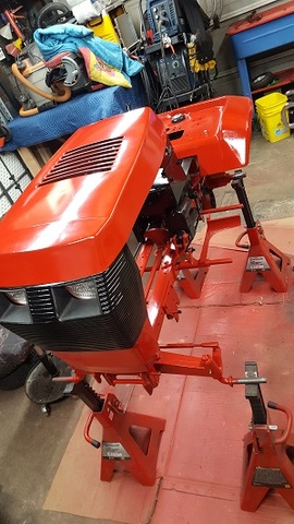

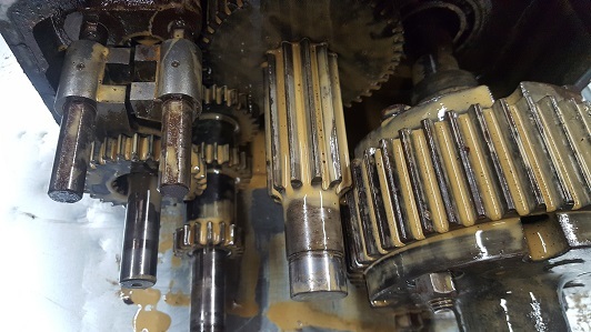

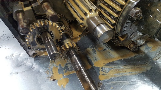

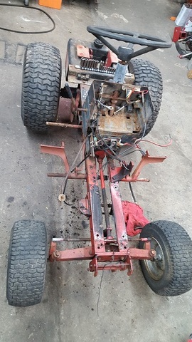

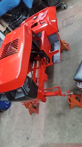

clemet 146 #1 Posted October 9, 2016 (edited) I posted a bit ago about the 2 tractors that followed me home. I finally had the time to start the tear down and rebuild on the 417. From what I can it is an 86 with a KT17 series 2. All the tags were missing off both the tractor and the engine. I pulled the front valve cover off, and cannot feel any major wear on the engine which is surprising considering it has over 1300 hours on it. My plan is to do all new gaskets and rings before it is all said and done just for the piece of mind. I picked this thing up from the coast in North Carolina so it is rusty not surface rust, but rusty. Luckily there are no holes in any of the sheet metal that I have found yet. Time will tell though since I still have to get into the sanding phase. Right now all I have done is tear it down, and because of the storm plus the peanut butter I found in the transmission I decided to tear it down and rebuild it first. I have new seals and axle bearings in the mail, and the transmission cleaned up. My parts washer almost needs a swap out of diesel again. I changed it right before I started on this. Edited October 9, 2016 by clemet 8 Share this post Link to post Share on other sites

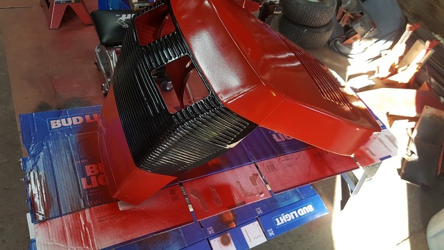

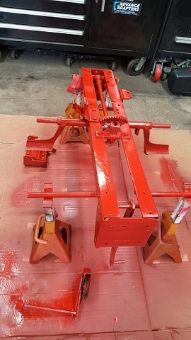

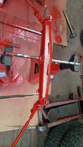

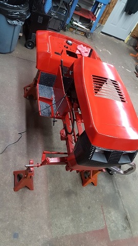

clemet 146 #8 Posted October 11, 2016 (edited) Todays progress. A little grinding, sanding, sand blasting and then prime and paint. Edited October 12, 2016 by clemet 3 Share this post Link to post Share on other sites

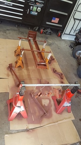

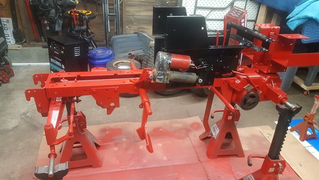

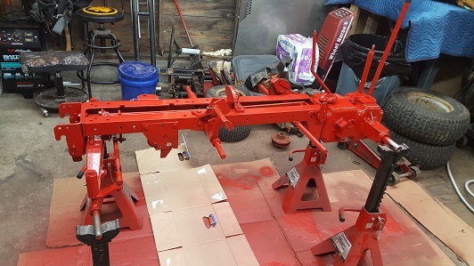

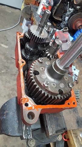

clemet 146 #11 Posted October 14, 2016 Got the transmission back together, and reinstalled. Now to work on the rest of the linkages and brackets before moving on to the sheet metal. 5 Share this post Link to post Share on other sites

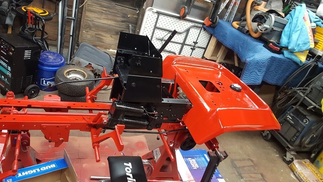

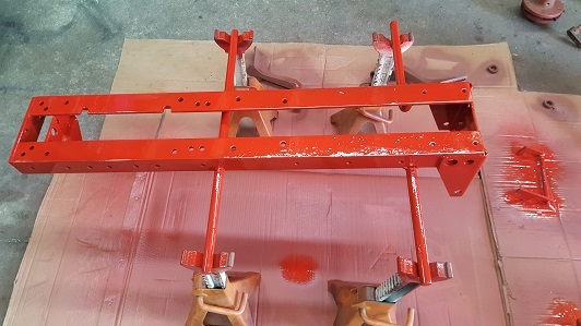

clemet 146 #13 Posted October 17, 2016 A little more progress. It seems like I spend more time waiting on paint to dry than anything else these days lol..... 3 Share this post Link to post Share on other sites

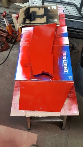

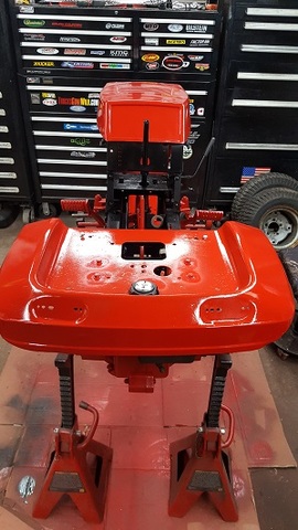

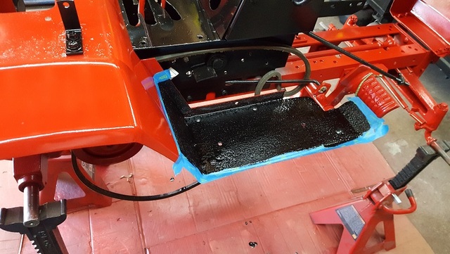

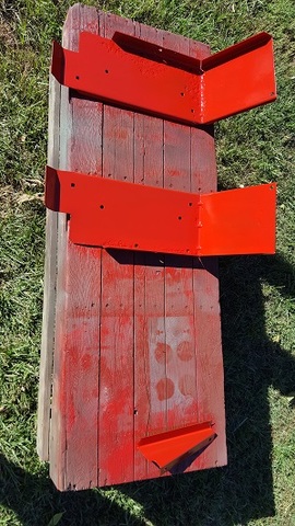

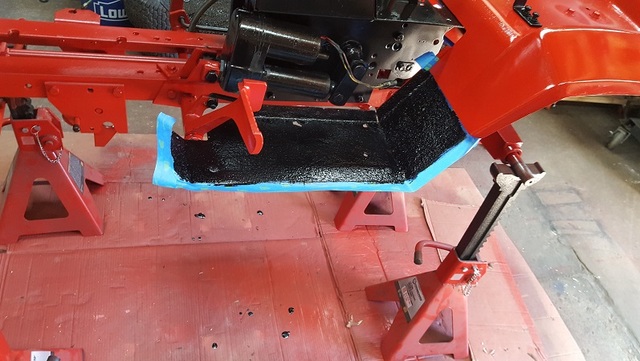

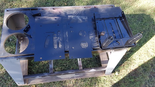

clemet 146 #18 Posted October 22, 2016 The sheet metal is all cleaned and painted. Now to just let it cure and bolt it on. Then comes the fun part of painting the bolts. Since the floorboards are pitted bad with rust I am going to just roll some bedliner on them for protection and traction. Next step will be to unmount the tires and paint the wheels. I ordered the engine rebuild kit, tires, and a couple other little parts today so once I get all that I can keep moving forward. I am looking forward to getting this one done so that I can pull my '73 in and give it a once over this winter. Share this post Link to post Share on other sites

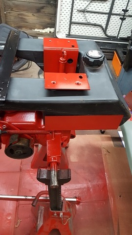

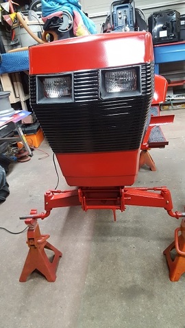

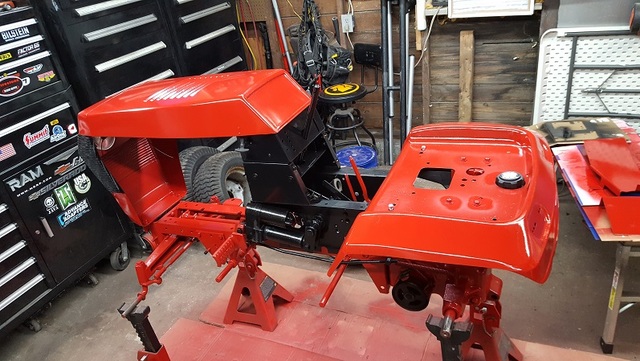

clemet 146 #19 Posted October 26, 2016 Got the rest of the sheet metal painted and installed. Bedliner is on the floorboards. Now to wait on the rest of the little parts, and pry this weekend start on the engine rebuild. 5 Share this post Link to post Share on other sites

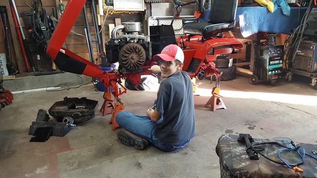

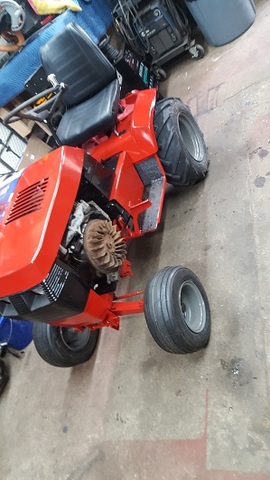

clemet 146 #20 Posted October 29, 2016 Getting a lot closer. A bunch more parts show up Monday, and then just waiting on the decals to ship. Plus I have to do the exhaust yet. I am glad that my 15yo son is helping and having a blast. 6 Share this post Link to post Share on other sites

clemet 146 #23 Posted October 30, 2016 19 hours ago, JERSEYHAWG / Glenn said: Watch out Carl, I think your son thinks your helping him work on HIS tractor. I have seen that look before. I like the bedliner on the floorboards idea to. Turning out really nice. Glenn I actually had to call his name a couple times just to get that picture vice the back of his head. He was very intent no getting the bolts tight. The good news is I have trained him well. Even though I have plenty of powerful impacts and such he goes for a pair of wrenches. 2 Share this post Link to post Share on other sites

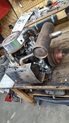

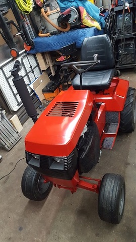

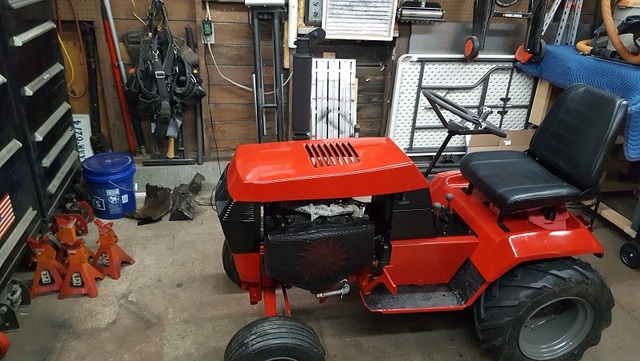

clemet 146 #24 Posted October 30, 2016 Today's progress. Got the exhaust done, and installed. 2 Share this post Link to post Share on other sites
