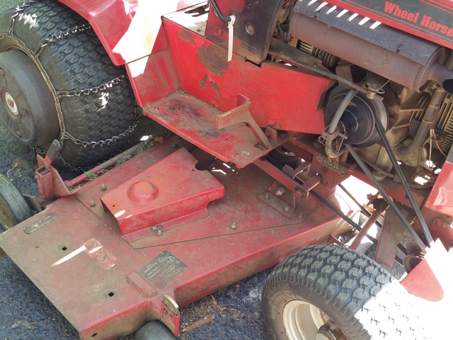

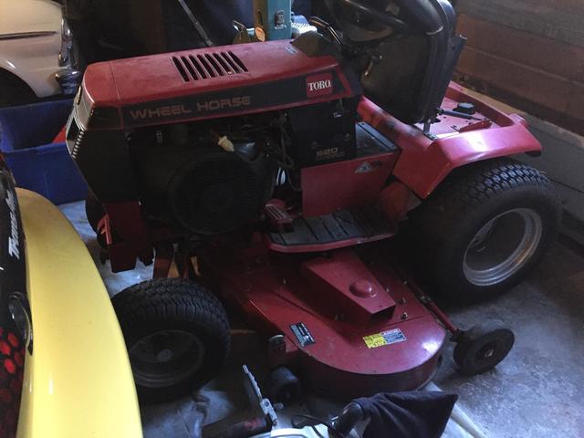

JERSEYHAWG / Glenn 4,499 #1 Posted October 8, 2016 Ok, I am looking at this 1996 520h, why is the pedal in this picture seem like it doesn't sit right? My 1995 520h, I didn't have long enough to remember. Do you guys see anything wrong with the position of the pedal. As always, thanks for advice and comments. Glenn 1 Share this post Link to post Share on other sites
benji756 341 #2 Posted October 8, 2016 possibly linkage is unhooked or broken? 1 Share this post Link to post Share on other sites
Theroundhousernr 590 #3 Posted October 8, 2016 Parking brake engaged? 1 Share this post Link to post Share on other sites
Wishin4a416 2,231 #4 Posted October 8, 2016 Just a guess but maybe the brake pad is worn badly and it is way out of adjustment. Looks like the foot/step rest is badly bent also as it doesnt tuck up under the fender. 1 Share this post Link to post Share on other sites
kasey54 305 #5 Posted October 8, 2016 I have one with the floor pan issue as well. It came about from sloppy tire chains getting caught. The previous owner caught it on fire trying to straighten or removing the floor pan . Made for a good deal for me. I don't remember about the pedal. 1 Share this post Link to post Share on other sites
Lagersolut 760 #6 Posted October 8, 2016 Walked out in the garage looked and took a measurement on a 310-8 - the pedal should be standing up 4" to the pedal pad and facing the operator - the pad on this tractors pedal is facing straight up towards the hood - methinks the pedal is broke or was broke and poorly welded . I've had linkage off pedals before and they didn't lay/sit like that. 1 Share this post Link to post Share on other sites
cleat 7,734 #7 Posted October 8, 2016 That is a later model pedal. They sit different. Mine are all early models so I cannot do a measurement. 2 Share this post Link to post Share on other sites
JERSEYHAWG / Glenn 4,499 #8 Posted October 8, 2016 1 hour ago, Wishin4a416 said: Just a guess but maybe the brake pad is worn badly and it is way out of adjustment. Looks like the foot/step rest is badly bent also as it doesnt tuck up under the fender. Jack, yes on the foot/ step rest. Bent pretty good to. He has a new one of those. The funky pedal is what bothers me. Amazing with only 351 hours on the machine. Glenn 1 hour ago, Theroundhousernr said: Parking brake engaged? Comment, when the brake is on, the pedal sits like that? Just seems way to weird, the angle......just sayin and not sure. Glenn Share this post Link to post Share on other sites
Wishin4a416 2,231 #9 Posted October 8, 2016 1 minute ago, JERSEYHAWG / Glenn said: Jack, yes on the foot/ step rest. Bent pretty good to. He has a new one of those. The funky pedal is what bothers me. Amazing with only 351 hours on the machine. Glenn It wouldnt deter me if price and hours were right. And hours seem very right. 1 Share this post Link to post Share on other sites

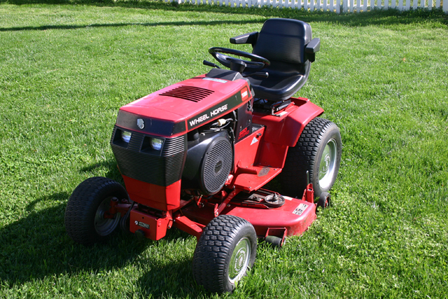

Lagersolut 760 #10 Posted October 8, 2016 3 minutes ago, JERSEYHAWG / Glenn said: Jack, yes on the foot/ step rest. Bent pretty good to. He has a new one of those. The funky pedal is what bothers me. Amazing with only 351 hours on the machine. Glenn Here's a '96 520 I pulled off Google images you can use for reference - you can clearly see something isn't right on that pedal. 1 Share this post Link to post Share on other sites
shallowwatersailor 3,216 #11 Posted October 8, 2016 Looking at the pedal and the way the footboard is chewed up where it meets the fenderpan, what happened on that side underneath? 1 Share this post Link to post Share on other sites

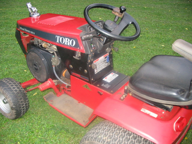

Wishin4a416 2,231 #13 Posted October 8, 2016 Here is a picture of mine Glenn. Adjusted correctly to the second detent. 4 Share this post Link to post Share on other sites
Theroundhousernr 590 #14 Posted October 8, 2016 Idk . Judging by the photo above.. that brake pedal looks about right to me. Could be out of adjustment or just parking brake is set. Now the foot rest is a whole other story...... 1 Share this post Link to post Share on other sites
JERSEYHAWG / Glenn 4,499 #15 Posted October 8, 2016 57 minutes ago, Wishin4a416 said: Here is a picture of mine Glenn. Adjusted correctly to the second detent. Jack, what year is yours? I forgot. yes, that brake pedal on the one I am looking at might be in the correct position. BIG MIGHT......but this does call for further investigation seeing my money tree died. Thanks for all the comments guys. If any one else spots anything let me know. I am still investigating it. Not sure yet. THE ASKING PRICE is 1400.....IMHO ,,a bit high considering. I do like the low hours. But I just bought one that needs a redo. WHO HAS A " C L E A N " one they want to sell? come on guys....one of you has one......lol Glenn 1 Share this post Link to post Share on other sites

Shuboxlover 482 #17 Posted October 8, 2016 Just a shot in the dark here, but I'm guessing tire chains are the culprit.....They can do some damage if the catch 2 Share this post Link to post Share on other sites

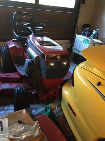

JERSEYHAWG / Glenn 4,499 #18 Posted October 8, 2016 50 minutes ago, Wishin4a416 said: I can not tell Glenn. Is that the one with the gold lettering. The anniversary model? I saw a very clean one at out local equipment auction in April go for 1250. I quit bidding at 800. It was low hours but surged. Yes, it does have the gold anniversary lettering Jack. good catch. I wll post a clearer picture when I get home. Glenn 32 minutes ago, Shuboxlover said: Just a shot in the dark here, but I'm guessing tire chains are the culprit.....They can do some damage if the catch you sir, win the prize. Glenn 1 Share this post Link to post Share on other sites

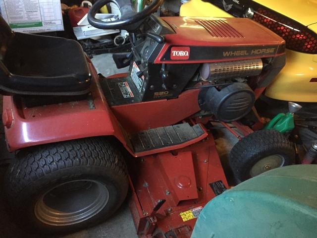

JERSEYHAWG / Glenn 4,499 #21 Posted October 8, 2016 Anniversary gold lettering, gold horse head. and the anniversary bent foot board, anniversary rip in seat.....etc. Glenn Share this post Link to post Share on other sites
Wishin4a416 2,231 #22 Posted October 8, 2016 I like it Glenn. Looks like it will clean up just fine. 1 Share this post Link to post Share on other sites

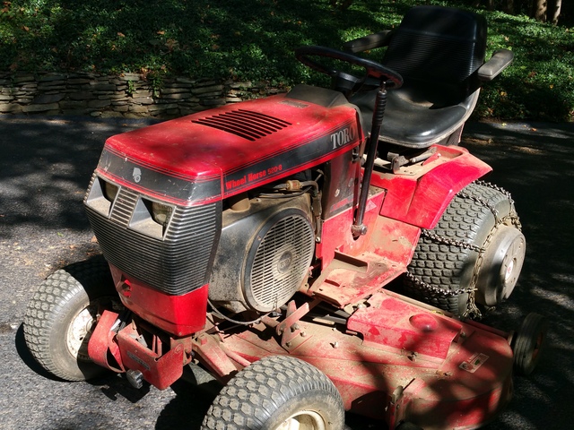

JERSEYHAWG / Glenn 4,499 #25 Posted October 8, 2016 32 minutes ago, DougC said: Glenn, you should be ashamed of yourself for having so many near mint, low hour 's Send a few to Iowa for a vacation, I'll give them free room and board!!!! As far as the position of the brake pedal, It is unlike any I have seen My 95 looks the same as my 88 and both look like the picture googled above. My short legs would have a problem reaching yours. Here Doug. this is to make us both feel better. My last mint purchase. mint dirt, mint rust. lol Glenn 2 Share this post Link to post Share on other sites
