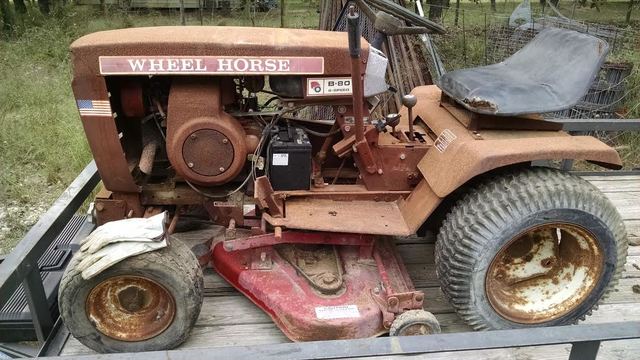

Junkers88 68 #1 Posted October 5, 2016 1970-something B-80. Rear tires are 22x7.50-12. One of them is so dry rotted that it's got holes in it and we're having a hard time finding a tire that doesn't cost us two weeks worth of gas to get back and forth to work. I mean honestly these things are expensive! I'd like to get an inner tube to use for a season and then buy all new tires once we get past the holidays, yes we live on that tight of a budget so that as much as possible goes into savings. Any practical reason not to use a $10 tube for the next 6 months? The other three tires are ok with only one of them having a slow leak but they are dry rotted as well. Thank you for your time. Richard. 1 Share this post Link to post Share on other sites

Junkers88 68 #17 Posted October 5, 2016 24 minutes ago, 953 nut said: Stick around, the member here have a wealth of knowledge to share. One more thing, Hehe. Just because you asked here is my $80 B-80. Richard 8 Share this post Link to post Share on other sites
roadapples 6,987 #18 Posted October 6, 2016 Seen worse than that on here come back to life....patience... 1 Share this post Link to post Share on other sites
