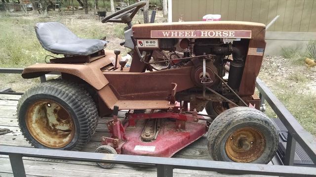

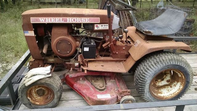

Jim Demery 405 #38 Posted August 14, 2017 On 10/3/2016 at 0:06 AM, Junkers88 said: Hey folks, Richard here out of Adkins Texas. I answered a Craigslist ad for a "lawn tractor, 100$" and it turned out to be a B-80 Wheel horse. I actually stumbled onto this site while trying to find out information on what a Wheel Horse was. So for $80 I pushed this one onto the trailer after the owner nicely sprayed some penetrating oil into the spark plug hole and turned it over with a set of jumper cables. I figured if it turned over $80 was a good enough deal for me. History on the tractor from the gentleman that sold it is that it was bought new in the mid 70's by a local school district to mow the ball fields and drag the infield dirt. After it was retired one of the school grounds guys (the owners father in law) bought it from the school to restore it and use it. It sat in a barn for 15+ years and then was moved out to the pasture for a few more and that's when I bought it. Got it home and started looking into getting it running and was able to start it and keep it running within about an hour using starting fluid. I had to replace the solenoid and fuel line as well as buy a battery for it. Had some leaks in the carb so I pulled the bowl and got the float unstuck and the leak stopped. This is where I'm at now. The ignition switch worked about a dozen times and then just quit. I cleaned the contacts to no avail and will need to replace it if I can find a factory part to put in there. Also the tractor will start and run with the PTO engaged but otherwise it will start and low low idle for about 7 seconds and then quit. Sounds to me like the carb needs to be rebuilt but to be honest I've never rebuilt one so I don't know what it entails, can't be too complicated though. It does need tires. I greased all the zerk fittings and checked all the fluids and will need to put some into the rear end. The deck spins nicely and looks to be newer as the paint isn't faded or too badly scratched and all the blades look either new or wilt little use. Any advice or help on the tractor would be appreciated. We need one to work the family garden this spring and mow an acre of coastal grass that we have around the place. Thank you in advance. Richard. That has the high-low transmission so it was made from 75-77 I believe. The carb on that 8hp Kohler is a piece of cake to rebuild and you can get a kit for it at your local Napa Auto Parts. There's several videos on YouTube that'll walk you through it also. Hope this helps you and good luck with the ole girl. Share this post Link to post Share on other sites
