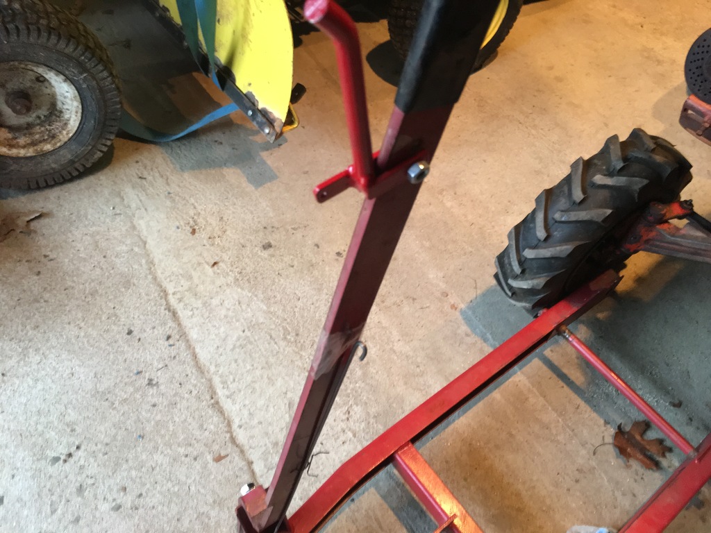

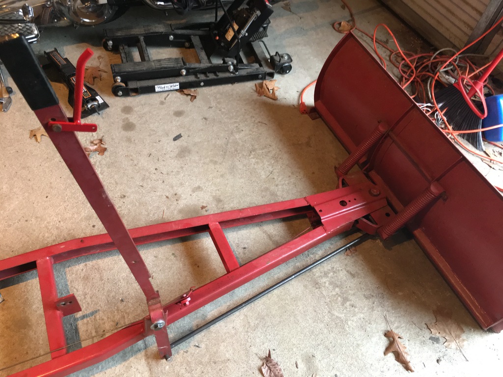

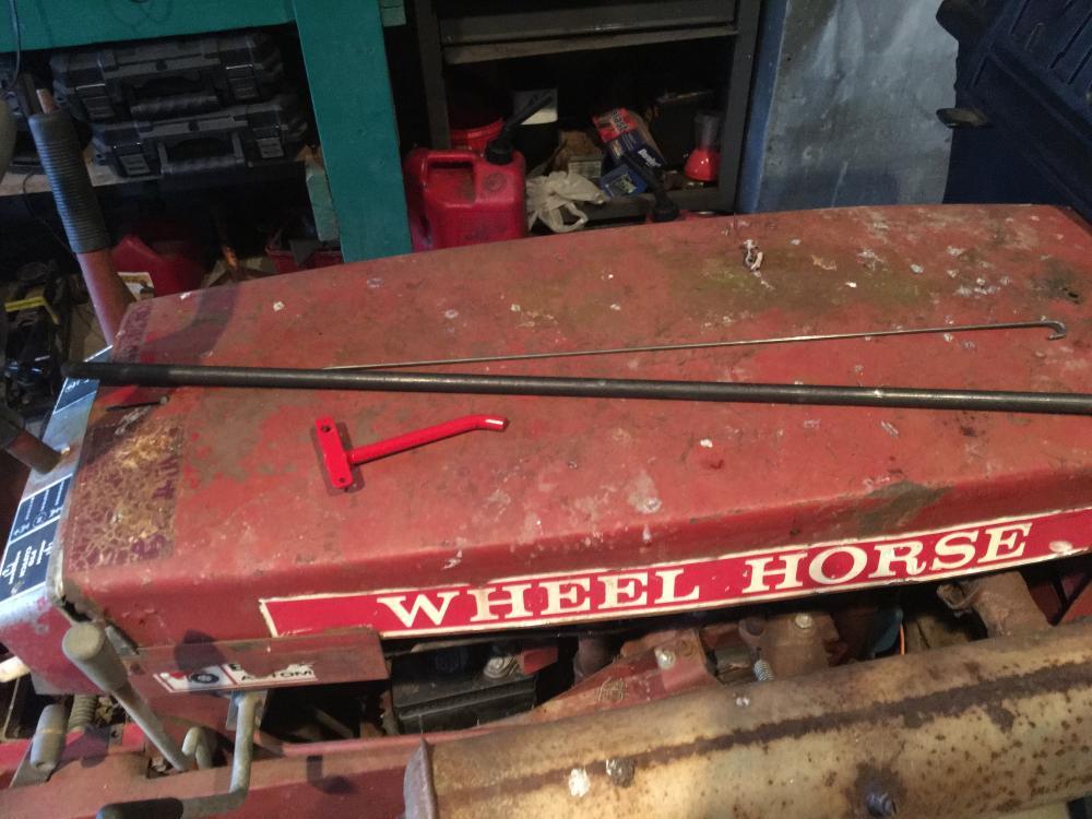

T-Mo-(Moderator) 4,345 #52 Posted January 2, 2017 I bought an used lever from member @Thor27, which I truly appreciate. He sent it to me for free, and I mean, free. I still need the trigger lever, trigger rod, and the angle rod. I had these made. I did get the trigger lever wrong, which Walt did tell me about, but I misunderstood him. After playing installing it, I can see where I did get it wrong, but I'm thinking it still should work. The problem is, the trigger rod is about 5 inches too short. The lever I got and the one Walt has, must be different. Mine may be longer. So that part has to be remade. 1 Share this post Link to post Share on other sites
