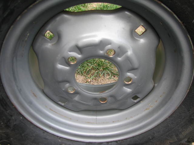

classicdmax 190 #1 Posted September 30, 2016 I found a set of 12x8.5 rims on eBay. Plan to sandblast and rattle can them satin black as I think the white/ivory color will stick out too much on a tractor with patina. I'm thinking I can run a 10.5 turf saver and keep that squared shape to the tire as I prefer. Any input on my intended tire size? Also, this set of rims will also be my second set, of which I am now unsure width of wheel currently on tractor(will check tomorrow) question two would be, if it's a diff size (narrower I would guess) which wheel size you be better suited for turf savers vs ag's as I plan to have both at some point when funds allow Share this post Link to post Share on other sites
pfrederi 19,933 #2 Posted September 30, 2016 Have you checked the backset on the rims. Rim width is only one factor. Most WHs used a small back set 1-3/8' Many other tractors had bigger backset. May have interference problems if you use 10.5s. What tractor are you planning on using them on? Share this post Link to post Share on other sites
classicdmax 190 #3 Posted October 1, 2016 Unsure on back spacing....good question and was prob assuming they were a proper fit. I suppose I'll find out when they arrive. going on a c160 Share this post Link to post Share on other sites
Sparky-(Admin) 24,646 #4 Posted October 1, 2016 27 minutes ago, classicdmax said: going on a c160 If it's an under the hood fuel tank tractor and I suspect it is, should be fine, but a tractor with the under the rear fender fuel tank may have clearance issues. Mike..... 2 Share this post Link to post Share on other sites
classicdmax 190 #5 Posted October 1, 2016 Under the hood its a 73 16h hydro Share this post Link to post Share on other sites
classicdmax 190 #6 Posted October 6, 2016 I didn't respect the back spacing, the wheels have clearance issues even with no rubber on them. Back spacing is 2-3/4". Needless to say I'll be posting a set of rims for sale here soon. Share this post Link to post Share on other sites
AMC RULES 37,254 #7 Posted October 6, 2016 Actually, it's pretty easy to change the back spacing on those wheels... then have 'em rewelded. 2 Share this post Link to post Share on other sites
classicdmax 190 #8 Posted October 6, 2016 Good idea, thanks. Another project on my long list of things to do haha Share this post Link to post Share on other sites
