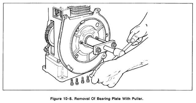

rmaynard 16,837 #8 Posted October 1, 2016 Why not use the same puller that you used to pull the flywheel? 3 Share this post Link to post Share on other sites
Joeyd 35 #9 Posted October 1, 2016 37 minutes ago, rmaynard said: Why not use the same puller that you used to pull the flywheel? I thought of that but the holes on the bearing plate aren't threaded. The bolts go through and thread into the block and there's no way to bring the bolt in from the back side. Unless I'm totally missing something like another threaded hole that I could use. Share this post Link to post Share on other sites
Shynon 7,533 #10 Posted October 1, 2016 Take off the oil pan, and the head, disconnect the connecting rod from the crankshaft. Push the piston out the top. Now tap on the end of the crankshaft with a dead blow hammer, sometimes the bearing plate will stick to the crankshaft so the crank will come out with the bearing plate attatched to it. 2 Share this post Link to post Share on other sites
rmaynard 16,837 #11 Posted October 1, 2016 7 hours ago, Joeyd said: I thought of that but the holes on the bearing plate aren't threaded. The bolts go through and thread into the block and there's no way to bring the bolt in from the back side. Unless I'm totally missing something like another threaded hole that I could use. I don't recall seeing a big block bearing plate that wasn't threaded. Hmm. Are you sure it's not just a larger size bolt you need? Share this post Link to post Share on other sites
Anglo Traction 761 #12 Posted October 1, 2016 8 hours ago, Joeyd said: I thought of that but the holes on the bearing plate aren't threaded. The bolts go through and thread into the block and there's no way to bring the bolt in from the back side. Unless I'm totally missing something like another threaded hole that I could use. I believe the Puller/Plate removal procedure shown in the Manual may refer to the use of the 2 Bolt holes on the horizontal plane that secures the Stator Plate. Should be threaded 10-24. Normally strong enough to part the Bearing Plate from the Crankcase, but if yours is stuck tight, it may be best to tighten the Puller up and gently bump the Pto end of the Crank to assist the seal break. 2 Share this post Link to post Share on other sites
rmaynard 16,837 #13 Posted October 1, 2016 My mistake. Memory doesn't serve me as well as it used to. Those holes are 10-24. The drawing from the manual does not indicate what engine they are showing. Share this post Link to post Share on other sites
