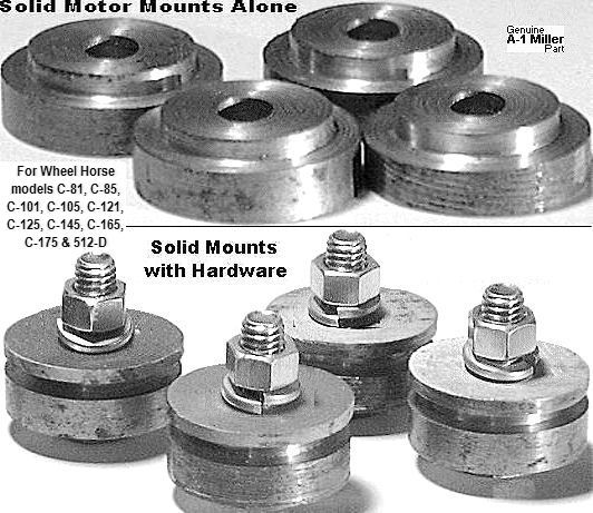

TDF5G 2,073 #17 Posted September 30, 2016 Does anyone have any pics of the solid mounts or conversions that can be shared here? Thanks Share this post Link to post Share on other sites
RJ Hamner 1,028 #18 Posted September 30, 2016 10 minutes ago, TDF5G said: Does anyone have any pics of the solid mounts or conversions that can be shared here? Thanks 5 Share this post Link to post Share on other sites

JERSEYHAWG / Glenn 4,499 #22 Posted September 30, 2016 6 hours ago, RJ Hamner said: Where can you buy those and how much? Thanks, Glenn Share this post Link to post Share on other sites
RJ Hamner 1,028 #23 Posted September 30, 2016 3 minutes ago, JERSEYHAWG / Glenn said: Where can you buy those and how much? Thanks, Glenn http://gardentractorpullingtips.com/a1miller.htm Scroll almost all the way down (everything is on one page) He makes them for Cub Cadets as well as Wheel Horse $40 without hardware $50 with Bob 2 Share this post Link to post Share on other sites
