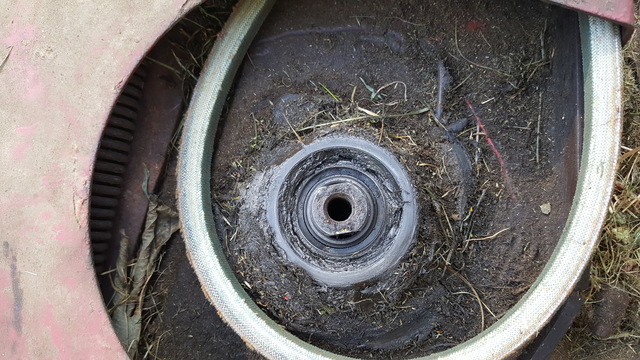

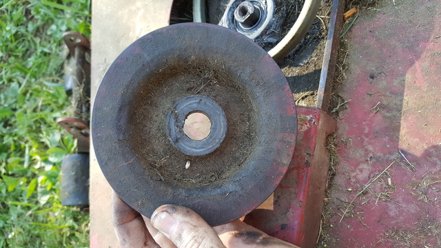

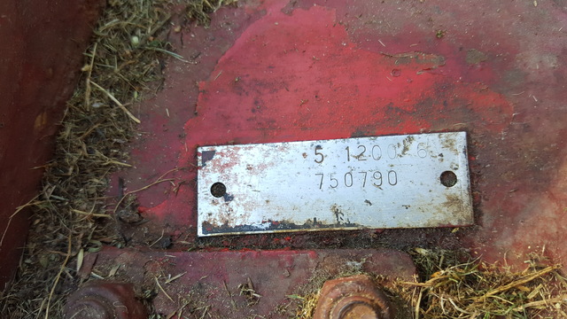

Kieran klein 0 #1 Posted September 27, 2016 Hey guys first time poster and I have a deck problem. Usually I can fix this 1971 raider 12 but now the deck is the issue. The center pulley is completely worn out. The spindle has 2 flat sidesign on the arbor. I don't know what kind do of bore this is called or what part number this is. If anyone can help that would be fantastic! Thanks Kieran Deck numbers Share this post Link to post Share on other sites
wildman 205 #2 Posted September 27, 2016 That bore is a double D Share this post Link to post Share on other sites
gwest_ca-(File Mod) 11,765 #3 Posted September 28, 2016 Here is a parts list if the spindles are original to the deck. This file shows the replacement spindle assemblies and their parts that were used over the years. Garry Share this post Link to post Share on other sites

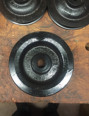

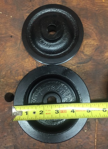

Aldon 4,828 #4 Posted September 28, 2016 (edited) Kieran, Looks like your located fairly close to my old stomping grounds. I went to School in Christiansburg. Its hard to see in the pic but inthinknyour indicating that the Double D flats inside the bore of pulley have worn round. As such, you may need more than a new pulley. You may hve to rebuild the spindle and replace bearings. I have a set of refurbished pulleys. The Double D flats are not mint but pretty decent. PM me if you decide your interested. i have everything cleaned up except bearings. Pulleys, Housing and Spindle Shafts. Edited September 28, 2016 by Aldon Share this post Link to post Share on other sites
Kieran klein 0 #5 Posted September 28, 2016 Thank you everyone for the info! I am 16 miles from christiansburg so I'm not too far at all. I'll send you a pm Share this post Link to post Share on other sites

Kieran klein 0 #7 Posted October 1, 2016 (edited) On 9/27/2016 at 8:54 PM, Aldon said: Kieran, Looks like your located fairly close to my old stomping grounds. I went to School in Christiansburg. Its hard to see in the pic but inthinknyour indicating that the Double D flats inside the bore of pulley have worn round. As such, you may need more than a new pulley. You may hve to rebuild the spindle and replace bearings. I have a set of refurbished pulleys. The Double D flats are not mint but pretty decent. PM me if you decide your interested. i have everything cleaned up except bearings. Pulleys, Housing and Spindle Shafts. These fit and work. Thank you very much for the help! Great community! Edited October 1, 2016 by Kieran klein Share this post Link to post Share on other sites
