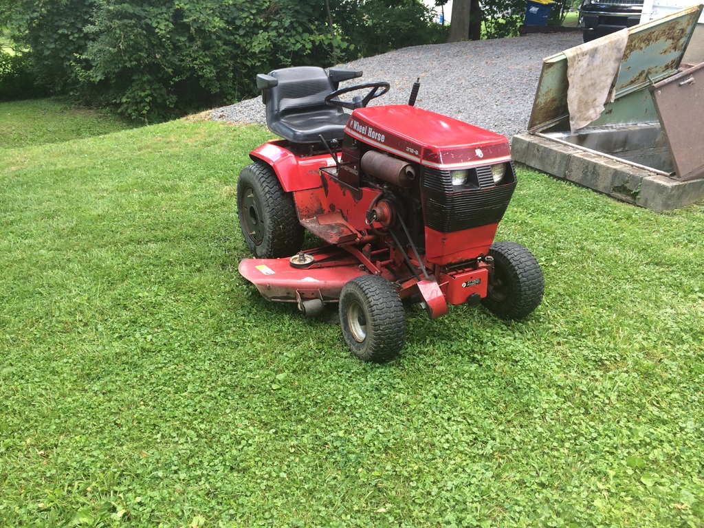

WH520 17 #1 Posted September 26, 2016 Hi everyone, it's been awhile since I've been here. I'm having some issues with my 93 312 with the 12 horse Kohler. Last weekend I went to start it and it wasn't firing at all so I sprayed some carb cleaner in the carb and it fired up for a second but wouldn't restart. I pulled the fuel lines off the fuel pump and had gas going to the pump. I left the line off the pump on the side that goes to the carb and turned it over and gas came shooting out. I hooked the line back and it started right up and ran great for the hour it takes to mow my yard. Fast forward to this weekend. I went out to mow the grass and it's doing the same thing again, not firing. I pulled the line off the pump and turned it over but this time there is no gas being pumped out. I tore the pump apart and from what I could tell everything looked ok. I could hear the check valve clicking on the inlet side when I blew into it. I tried sucking on the outlet side but I couldn't hear anything. I didn't get very good suction on it though because, well, gas fumes don't taste very good lol. Does anybody have any suggestions? Is there a rebuild kit for these or can you still buy a fuel pump? I tried looking them up but didn't have much luck. Thanks guys, sorry for the long post! Share this post Link to post Share on other sites

WH520 17 #6 Posted October 15, 2016 Hi guys, I figured I'd give an update. I ordered a new pump from NAPA and installed it yesterday and it fired right up! Now I've got an issue with one of the deck spindles, always something lol Thanks everybody for your help. 1 Share this post Link to post Share on other sites
WH520 17 #7 Posted June 18, 2017 (edited) Hi guys, thought I'd give an update and ask a question. I replaced the fuel pump last fall and mowed my yard twice before the new pump quit working on me. So fast forward to a few weeks ago. I ordered another fuel pump, replaced the fuel lines and put a new petcock on the tank. The tractor fired right up and was running good. Again, I mowed the yard twice and now it's not pumping fuel again. It's getting a good fuel flow from the tank to the pump. Whats the the chances of getting 2 bad pumps and only getting 2-3 hours out of them ? Am I doing something wrong on installation? I just ordered another pump off eBay, I thought I'd try to get some tips off the experts here. Edited June 18, 2017 by WH520 Share this post Link to post Share on other sites
