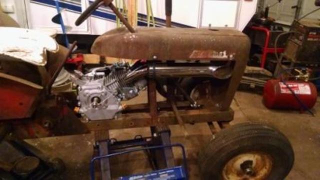

Achto 29,390 #3 Posted September 24, 2016 Old motorcycle parts can be adapted. This is a Harley Sportster muffler. The head pipe is covered with a peace of heat shield, also from a Sportster. 4 Share this post Link to post Share on other sites

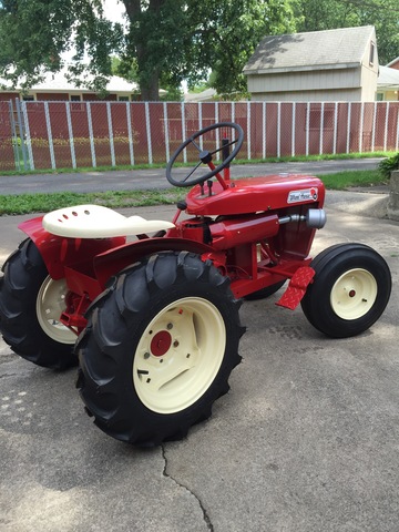

AlwaysLookin80 1,308 #4 Posted September 24, 2016 Put stainless on mine when I restored it. I like the way it came out. 5 Share this post Link to post Share on other sites

Achto 29,390 #6 Posted September 25, 2016 2 hours ago, Skeeters65 said: That's similar to what I had in mind. What is that motor The motor is a Harbor Freight engine that I bought new then took apart & did some modifying to, internal hot rodding. I made my own head pipe, started with a go kart flange then used a piece of 90degree bent 3/4" conduit into a larger pipe to adapt to the Sporty muffler. I bolted my muffler in place on the tractor then cut the conduit to fit from the head flange to the adapter pipe. Tack welded every thing in place then removed the head pipe so I could finish welding it together. . If the engine you are using has bolt holes for a flange fitting you can buy or make a flange for it. A piece of 1/8" to 3/16" thick steel, a drill , hole saw and a jig saw are pretty much all you'll need for tools. The Harbor Freight will bolt right into your tractor. You will need to remove their gas tank and use the original tank. The exhaust will need to be changed, and the top cover for the air cleaner needs to be removed. All of these alterations are to keep from having to alter the hood. I don't prefer to cut up original sheet metal. Good luck with your project, shoot us some pics when your done. Feel free to ask if you have any more questions. 1 Share this post Link to post Share on other sites

Achto 29,390 #8 Posted September 25, 2016 (edited) 56 minutes ago, Skeeters65 said: What size Predator motor are you using? What kind of internal work did you do? It's the 6.5hp, 212cc engine. I installed a billet rod, high compression piston,different cam, stronger valve springs. I also filed half of the fly wheel key off so that I could advance the timing. Bigger free flow air cleaner and larger exhaust required the main jet to be drilled out with a #67 drill bit. If I would change the carburetor, get rid of the governor, and change the fly wheel I should be able to get around 11hp at 7000RPMs. If you modify a Predator you need to keep in mind that the stock fly wheel comes apart at 5000RPMs. I wanted the fun of getting some extra power, but wanted to keep it tame enough to putt around at shows so I kept the governor, no need to change the fly wheel or carb at 3600RPMs. It is fun to pull wheelies on command,( let off the throttle then open it up again). I put wheelie bars on after I almost flipped it over backwards. Edited September 25, 2016 by achto 1 Share this post Link to post Share on other sites
