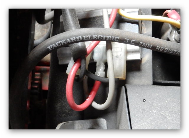

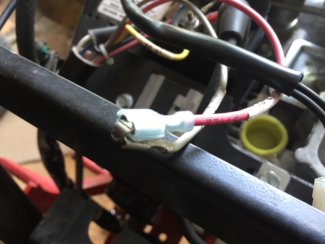

WNYPCRepair 1,924 #1 Posted September 22, 2016 So, I am finally putting the NOS engine in my 520-H But when I started to connect the regulator, I had these two wires connected together On my other 520-H, the red wire is on the center terminal, and the gray and black are connected together and then connected to an outside terminal, and black to the other outside terminal. This engine is actually a Linamar, the company that bought Onan, but otherwise it is the exact engine. Can anyone clarify the connections to the regulator? 1 Share this post Link to post Share on other sites

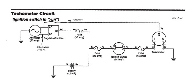

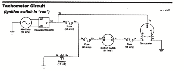

WNYPCRepair 1,924 #2 Posted September 22, 2016 Hmm... Looking at the wiring diagram, it shows the double wires on the center terminal, but my other two 520 engines have it on the outside terminal Share this post Link to post Share on other sites
Kurt-NEPA 756 #3 Posted September 22, 2016 Brian, There is an error in the wiring manual. It should look like this. My 1995 520H has a red wire from B+ to the fuse. 3 Share this post Link to post Share on other sites
WNYPCRepair 1,924 #4 Posted September 22, 2016 3 minutes ago, Kurt-NEPA said: Brian, There is an error in the wiring manual. It should look like this. My 1995 520H has a red wire from B+ to the fuse. I was just discussing it with a friend, and we decided no way it would work as the diagram shows. Thanks for confirming Tomorrow, I hook up the wires and put the fuel tank on and see how it runs. Break in procedure, anyone? 2 Share this post Link to post Share on other sites

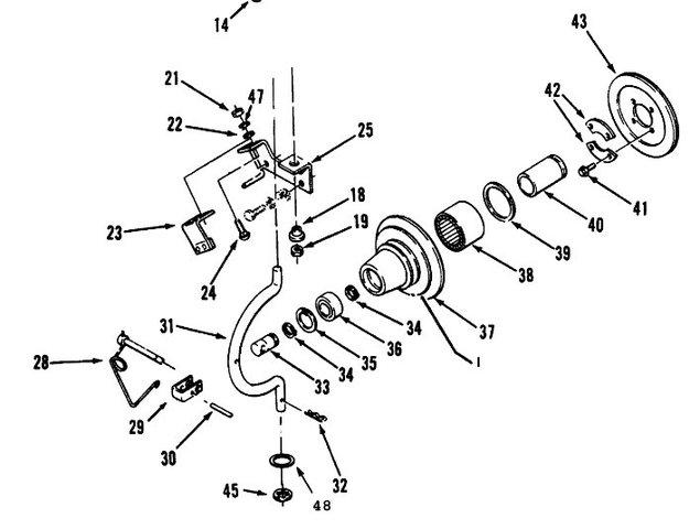

WNYPCRepair 1,924 #10 Posted September 24, 2016 Got the regulator wiring straightened out, and now it charges, and the tach works, but the tack needle starts at 1,000 RPM, and goes up from there. It starts at 1,000 regardless of ignition switch position. Has anyone seen this before? Also, any tips on engine break in, and /or removing the drive pulley? I was going to use a gear puller, just want to be sure I'm not missing anything. Share this post Link to post Share on other sites
Kurt-NEPA 756 #11 Posted September 24, 2016 On removing the pulley. Assuming its the drive pulley on the donor engine. Remove the hoop and brake and the pulley should pull off the shaft (#40). That sleeve is held in place by the parts #42, just remove 4 bolts, pull off parts #42 and the sleeve (#40) will pull off. Often it takes a bit of persuasion to get it out of #43. If its coming off the 520H I sold you, it should come apart easily as I had it off to replace the crank seal. I also replaced bearing #36, bearing #38 was in good condition Hope that helps. Kurt 1 Share this post Link to post Share on other sites
WNYPCRepair 1,924 #12 Posted September 24, 2016 1 hour ago, Kurt-NEPA said: On removing the pulley. Assuming its the drive pulley on the donor engine. Remove the hoop and brake and the pulley should pull off the shaft (#40). That sleeve is held in place by the parts #42, just remove 4 bolts, pull off parts #42 and the sleeve (#40) will pull off. Often it takes a bit of persuasion to get it out of #43. If its coming off the 520H I sold you, it should come apart easily as I had it off to replace the crank seal. I also replaced bearing #36, bearing #38 was in good condition Hope that helps. Kurt I'm down to part #43, and it does not want to give, despite a week of soaking with Kroil every few hours. And of course, I can't find my gear puller. Guess I'll have to go buy one. Share this post Link to post Share on other sites
WNYPCRepair 1,924 #13 Posted September 24, 2016 OK, bought a hydraulic gear puller, made short work of the drive pulley. Got it all back together. Next year is paint all the tins. New motor starts immediately, and purrs like a kitten. 2 Share this post Link to post Share on other sites
