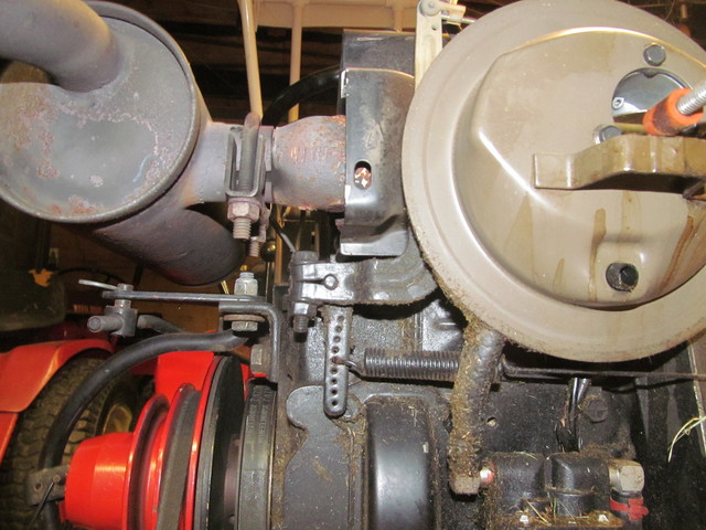

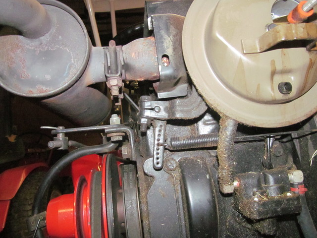

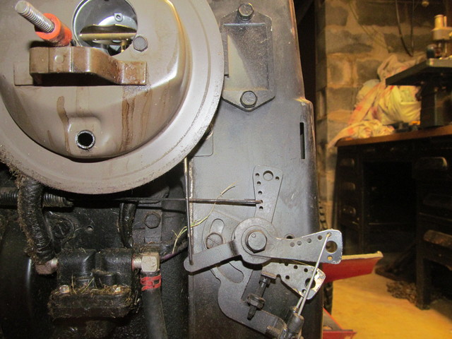

Ed Kennell 44,623 #2 Posted September 22, 2016 Does this help? 1 Share this post Link to post Share on other sites
Anthony Wendover 124 #3 Posted September 23, 2016 Thank you so much! shows everything very good!!! One more question.. how much does that spring bend when you have it completely idled down? Mine really twists and shoves way out in the middle and pushed up against the fuel line to carb and wore a small hole in the line. Share this post Link to post Share on other sites
Ed Kennell 44,623 #4 Posted September 23, 2016 (edited) The fuel line is cut long and the fittings on the carb and fuel pump are turned to the front so the fuel line bends out to clear the spring. The first picture is at idle. The 2nd and 3rd pictures are at full throttle. You should be able to adjust the throttle sheath position in its clamp to take the buckle out of the spring. Edited September 23, 2016 by Ed Kennell Share this post Link to post Share on other sites

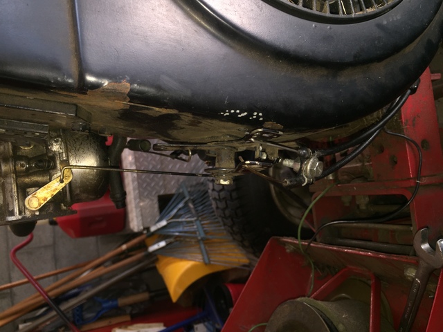

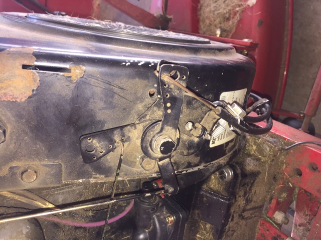

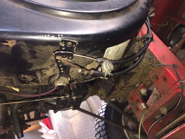

Anthony Wendover 124 #7 Posted September 24, 2016 Here are some pictures. I haven't had this tracctor working for two years haven't had time to fix it. Now I'm using it again and just found this issue with it. Iv tried hooking the cable threw a different eyelet and have tried moving it up or down in the holder for it. So I have a wider range with the lever. Like I said when the lever on dash is all the way up I have full throttle and before I get it to half way down it's already on low throttle. Share this post Link to post Share on other sites
wallfish 19,045 #8 Posted September 24, 2016 Move the throttle cable out to the end hole That will give you more travel on the control lever. If it's not enough, move the spring where it connects to the gov arm closer to the pivot point. Share this post Link to post Share on other sites
Ed Kennell 44,623 #9 Posted September 24, 2016 (edited) OK, so we can assume the throttle was not set up properly from the beginning. It is clear in your last photo with the throttle at idle, the spring is being pushed so hard that it is almost disengaging from the lever. I would start by putting the throttle cable wire in the upper left hole of the lever. This is where mine is. The spring appears to be in the same hole as mine, but I can not see the other end where it is attached to the governor lever. Mine is in the center hole. Then close the throttle to the idle position. If the spring still looks like it is being pushed out of the lever, loosen the bolt at the slot and rotate the throttle lever assembly till the spring stays in the hole and the carb is at the idle position. oops, I see Fish types faster than me. Edited September 24, 2016 by Ed Kennell Share this post Link to post Share on other sites
Anthony Wendover 124 #10 Posted September 24, 2016 Thank you both. I put it in first hole and adjusted the bracket. The spring in the governor is in the middle hole. Still unable to get the throttle lever to fully control it. Only half of it. But in other news the crappy replacement fuel pump that are plastic just broke the side fitting off of it so I'm not thrilled I gave up for now :/ Share this post Link to post Share on other sites
