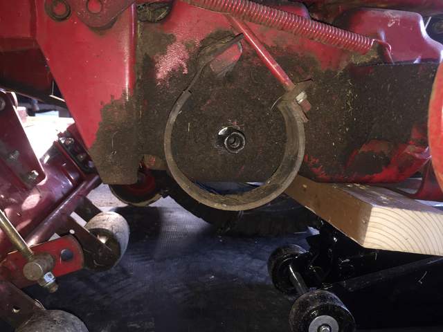

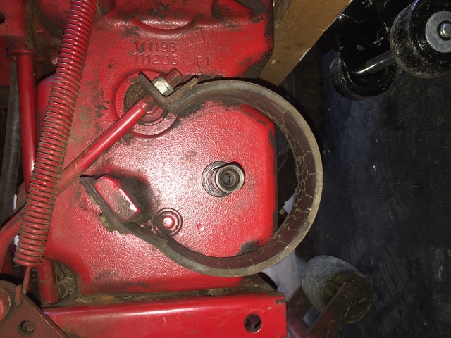

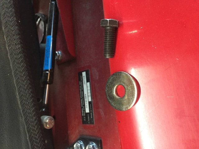

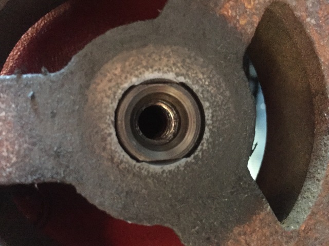

oldredone 2 #1 Posted September 21, 2016 (edited) So I was crusing down the lawn yesterday when I saw this shiny piece of metal in the grass.. Coming up on it i could see it looked like a small metal wheel. i went to put my foot on the brake to stop and check it out and petal to the floor! thankfully I got the tractor stopped but quickly found out this was my brake drum which had snuck out sometime earlier in the cut. It's from a 1986 414-8. Does anyone know the size / type of bolt and washer that hold this thing into the tranny? thanks all!!! Edited September 21, 2016 by oldredone pics 1 Share this post Link to post Share on other sites

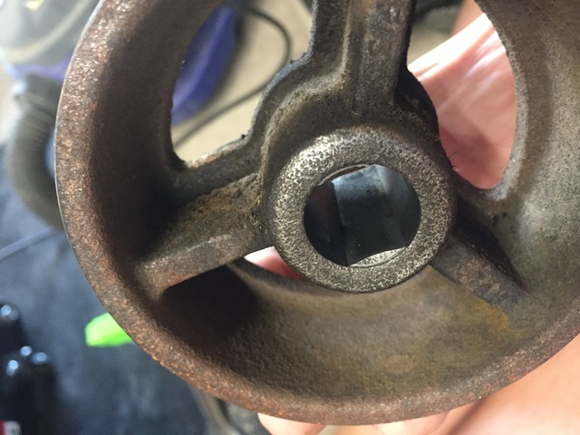

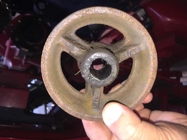

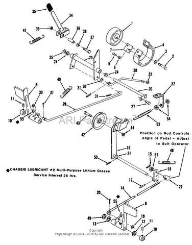

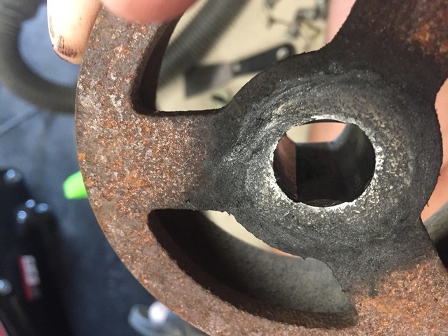

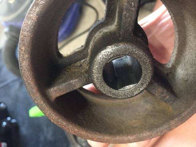

daveoman1966 3,880 #2 Posted September 21, 2016 (edited) Your brake DRUM looks like the DD hol;e is really wallowed out.... item # 1 in this schematic. it is part # 106719 and I have a good one. The bolt that holds it on is item 2 in the schematic and is part # 110234... I ahve that too. my direct email is: daveoman@windstream,.net Edited September 21, 2016 by daveoman1966 2 Share this post Link to post Share on other sites

Pullstart 68,291 #5 Posted September 22, 2016 I'm thinking this would be a 3/8-16 bolt, not sure of length but probably 1.5 - 2" Share this post Link to post Share on other sites
gwest_ca-(File Mod) 11,757 #6 Posted September 22, 2016 Have the 110234 replacing 513356 3/8"-16x3/4" Nylok Garry Share this post Link to post Share on other sites

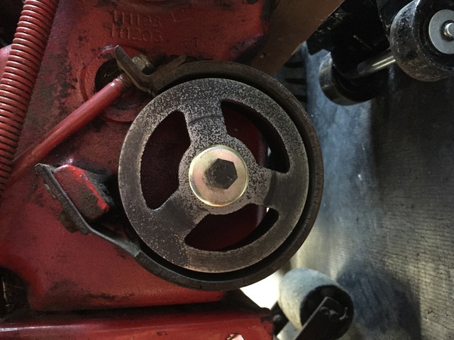

oldredone 2 #7 Posted September 23, 2016 Update! Thanks to all for their help. Dave, I took a close look and attached some pics, the drum, when dry fitted, sizes up tight to threaded "axle" so to speak. No play whatsoever when the wheel is held tight. My local toro dealer got me hooked up with an appropriate washer and I found a bolt that worked. Pullstart, right on, 3/8" 16. Now I just have to snug it up when I get home and dial in the brake. Thanks again everyone! 1 Share this post Link to post Share on other sites
