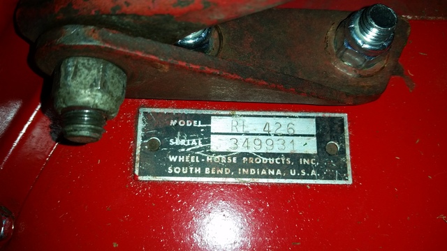

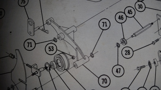

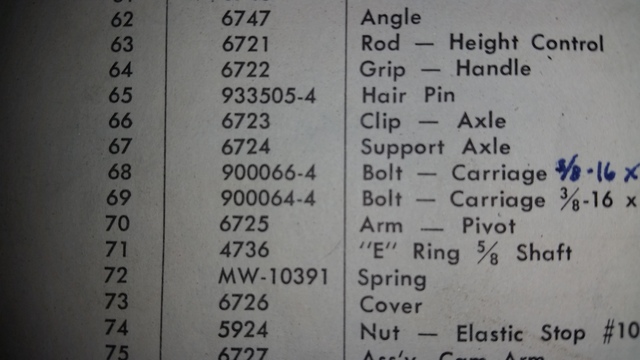

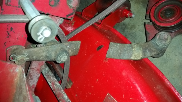

raider9 40 #1 Posted September 21, 2016 I stayed up late last night to finish up on my mower deck. I had predicted Wednesday for the trial run but I just Couldn't wait. Anyway, The deck was working great until my pivot arm broke in half. It looks like someone before me welded it once already. Some dummy (ME!!!) didn't realize you need a pin to lock the deck in the front bracket and I hit a bump that jarred it loose. Needless to say I ended up with a broken pivot arm and a hard lesson learned. I looked a little on ebay but haven't had much success. The deck is a 1967 RL-426. I've attached some pictures. It's item 70 in the the drawing which is part # 6725. Let me know if anyone can help me out. Thanks! Share this post Link to post Share on other sites
raider9 40 #2 Posted September 21, 2016 I found it on partstree.com for $100 plus shipping. Let me know if anyone has one for cheaper please. Thanks again! Share this post Link to post Share on other sites
tunahead72 2,597 #3 Posted September 21, 2016 I found a Toro pivot arm part no. 6725-01 (same part?) from RCPW and RepairClinic for $85-$90 plus shipping. But RepairClinic says it's not in stock, which could mean it's no longer available. I would put a wanted ad in our classifieds here, or try contacting one of the vendors, you might be able to find a used one for much less money. Share this post Link to post Share on other sites

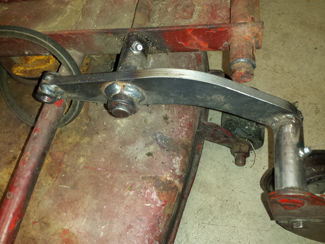

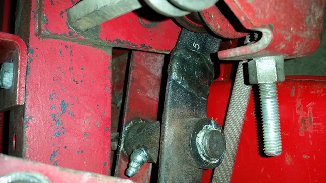

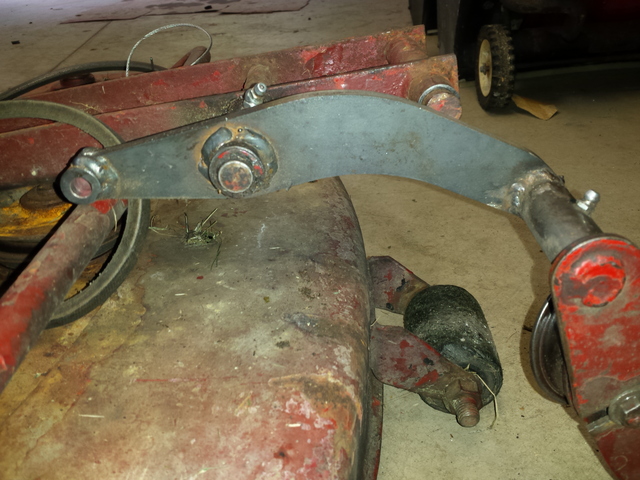

CasualObserver 3,411 #5 Posted September 21, 2016 That is a common broken part on those decks... seen a lot of them brazed back together. It is cast, so beware a welding shop might just tell you no. Place a classified/wanted ad for it... there are used parts vendors that watch those instead of out here in the forum. Share this post Link to post Share on other sites
raider9 40 #6 Posted September 21, 2016 We have cast iron rod for our stick welder at work. I'm going to have one of my guys try to fix it. Worst case I'll end up buying one from a vendor here, or for $100 at partstree.com. Thanks for the help! Share this post Link to post Share on other sites
moe1965 770 #7 Posted September 22, 2016 I had the same issue. Had a friend make one out of steel. It should never break again. He can make you one for 120.00. That would include the shipping 1 Share this post Link to post Share on other sites
raider9 40 #8 Posted October 1, 2016 On 9/22/2016 at 6:15 PM, moe1965 said: I had the same issue. Had a friend make one out of steel. It should never break again. He can make you one for 120.00. That would include the shipping I appreciate the offer. I got mine fixed for now. That cast rod is pretty nice stuff. If it breaks again I'll just make one at work myself. 1 Share this post Link to post Share on other sites
