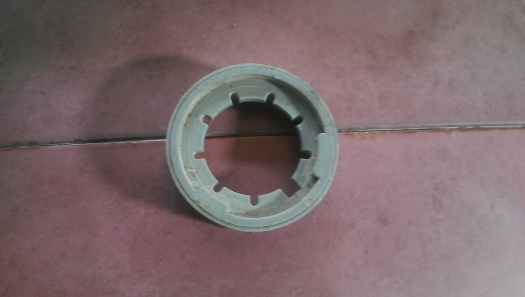

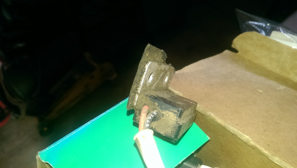

WVHillbilly520H 10,378 #9 Posted February 3, 2017 It could be the ignition module and rotor behind the flywheel ,Jeff. 3 Share this post Link to post Share on other sites

ericj 1,579 #11 Posted February 18, 2017 On 2/3/2017 at 5:02 AM, WVHillbilly520H said: It could be the ignition module and rotor behind the flywheel ,Jeff. the ignition module is a common problem with the onans. I have had several onans with bad ignition modules on them. check the onan manual it will tell you how to check it. when it cuts out and won't start next time get a volt meter and put it on the negative terminal of the coil and the negative terminal on the battery, you should read 12 volts, now spin the motor over by hand slow. the voltage should drop to 1.5 volts and the go back to 12 volts, if it does not do this then the ignition module is bad. please double check the manual to be sure I'm explaining this correctly, it's been awhile since I did this so I want to make sure I telling you right. Isn't there a pinned thread at the top of a section on how to check your onan, not sure if it's in motors or electrical, it was started by Martin a couple of years ago. eric j 2 Share this post Link to post Share on other sites
