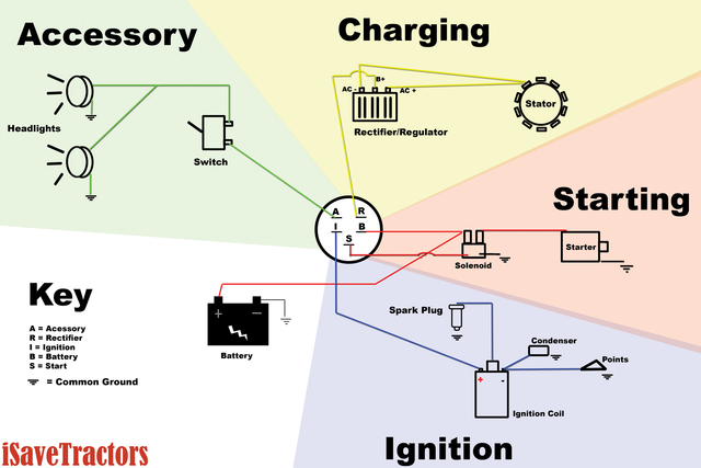

Texas Todd 1,025 #5 Posted September 20, 2016 I copied this the other day for future reference. Maybe it will help. 6 Share this post Link to post Share on other sites
rmaynard 16,567 #6 Posted September 20, 2016 The chart above is for a battery ignition. The M8 is magneto and a completely different wiring set up. I will try to post a simple diagram later. Share this post Link to post Share on other sites

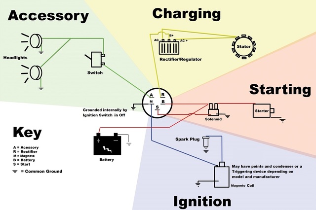

953 nut 62,117 #7 Posted September 20, 2016 3 hours ago, HD-Horse said: copied this the other day for future reference. Maybe it will help. I took the liberty of redrawing the Ignition portion of the great drawing HD-Horse posted to make it a mag. drawing. Keep in mind you will need a new ignition switch that will ground out the "M" terminal rather than putting 12 volts on the coil. 1 Share this post Link to post Share on other sites
Texas Todd 1,025 #8 Posted September 20, 2016 Cool! Saved that one too. Had kind of a Where's waldo moment looking for the differences! 1 Share this post Link to post Share on other sites
