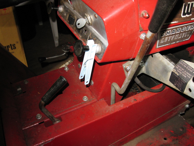

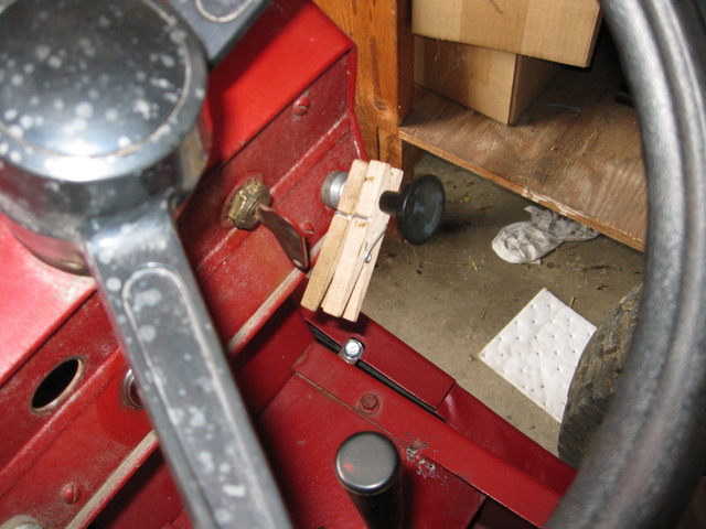

pfrederi 19,878 #3 Posted September 20, 2016 Even cheaper is this redneck fix. one clothes pin fast idle..two pins full throttle 5 Share this post Link to post Share on other sites

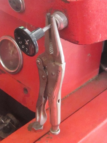

ztnoo 2,302 #5 Posted September 20, 2016 Here's my "Hoosierized" half-assed solution to this nagging problem. As opposed to the 'clothespin solution', my fix it allows for much finer throttle settings, due to the slender width dimensions of the securing "tool". It's a old man's solution to something that works, which didn't work before........and I didn't have to spend untold hours making the fix showroom perfect. It allows me to continue to make weekly use of my 47 year old machine during mowing season, without much concern. C'est la vie. My one and only WH is is working steed......any way I can get it done. No trailer queens around my acreage. 1 Share this post Link to post Share on other sites
Aldon 4,832 #6 Posted September 20, 2016 (edited) Pretty much all the replacements lose their locking capability. I have yet to find a high quality locking cable of same style as original. I was told that their might be a better quality cable of similar style that was for really old Jeeps. Have not found that but have not spent a lot of time searching either. I end up using a small set of vice grips as sown above. Edited September 20, 2016 by Aldon 1 Share this post Link to post Share on other sites
KC9KAS 4,746 #7 Posted September 20, 2016 1 hour ago, ztnoo said: Here's my "Hoosierized" half-assed solution to this nagging problem. As opposed to the 'clothespin solution', my fix it allows for much finer throttle settings, due to the slender width dimensions of the securing "tool". It's a old man's solution to something that works, which didn't work before........and I didn't have to spend untold hours making the fix showroom perfect. It allows me to continue to make weekly use of my 47 year old machine during mowing season, without much concern. C'est la vie. My one and only WH is is working steed......any way I can get it done. No trailer queens around my acreage. Hey, that is what I use on my GT-14 (and a couple of others)! Share this post Link to post Share on other sites
ztnoo 2,302 #8 Posted September 20, 2016 Hey...............it's great to know I'm not alone solving this problem. 1 Share this post Link to post Share on other sites
