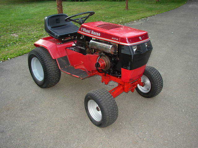

SPINJIM 1,986 #12 Posted September 21, 2016 I went to look at the 417-8 today in person. It looked a lot better on the internet than in person. Seller had washed it, and painted some of it with wrong colors. Fair amount of peeling paint. It has electrical problems and some broken clutch linkage. I made the seller an offer lower than his asking price, but he turned it down, probably because he just listed it three days ago. Engine sounded good, and only had 488 hours, but they must have been hard hours. I passed on it. Instead I've decided to get a newer snow thrower with the high chute to use on my 312. I've been told that the high chute makes a difference compared to the short I used last year. But I'll also keep my eyes open for a better 417. Thanks for all of the help and advice. Jim 3 Share this post Link to post Share on other sites
Ken B 3,202 #13 Posted September 21, 2016 (edited) Get the tall chute thrower and continue to look for a tractor with more Horse power. Bottom line is more Horse Power with a thrower equals more satisfaction and that turns into more fun.. I had a 417-8 with almost 2000 HARD hrs. on it and she still ran excellent when I let it go. Peeling paint is the norm for these year tractors, electrical bugs are as well and they aren't too hard to sort out. More than likely he painted the two side panels as they almost always peel.. They are very easy to take off and repaint in a color that matches better. Without seeing pics of that 417 and what his asking price is there is no way for us to know whether it was a deal or not... 488 hrs is very low hrs. There is never a way to tell if they are accurate but if you know what to look for and what a low hr tractor should feel like that really helps. I also had a 417 with 400 hrs. and it was a world of difference from the one I had with 2000 hrs. on it. Cosmetics are an easy fix.. Edited September 21, 2016 by Ken B 2 Share this post Link to post Share on other sites

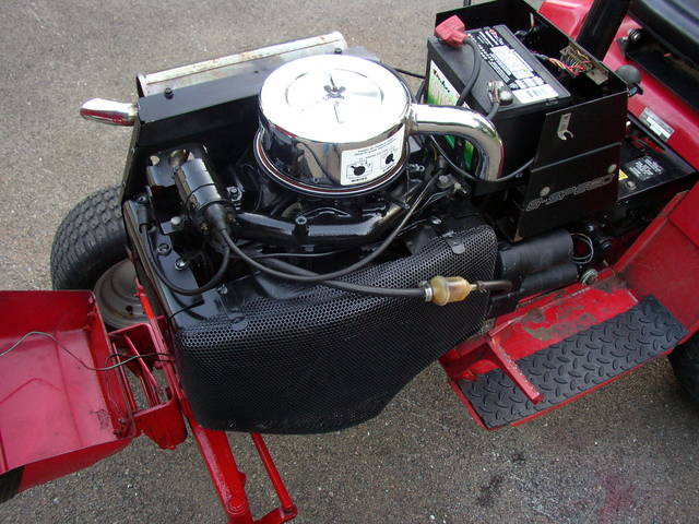

SPINJIM 1,986 #14 Posted September 25, 2016 BOUGHT IT ! I guess ACman and bmsgaffer were right. I really wanted the 417-8. Decent twin engine WHs are hard to find, and I can't afford a 520, so I bought the 417. I figured that snow throwers are easier to find than 417s. The 417 needs a little work, but the engine runs great, and only has 488 hours. Forked over $600 for it, but considering that I got my 312-8 for $50 last year, I'm averaging $325 each. The 417 will run a snow thrower of some kind, and the 312 will be my plow tractor. 5 Share this post Link to post Share on other sites

Wheel-N-It 2,976 #18 Posted September 25, 2016 A 417 with so few hours for $600? Yeah, I would have done that! I don't care what else that one could possibly need, only a fool would have walked away from the one in the pic. You did real good 1 Share this post Link to post Share on other sites
