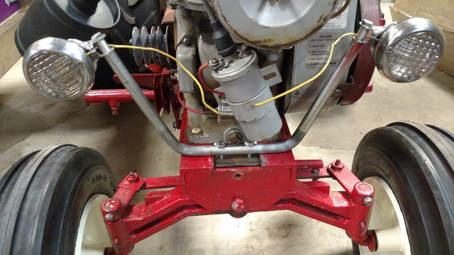

hcminis 1,796 #1 Posted September 19, 2016 Added a nice HL-5 to my newly acquired 701. The lights are not exact HL but very close. Ron Greco is working on finding me a replacement lens for the correct lights. The lights came from Scott and have an extension which I have never seen. 13 Share this post Link to post Share on other sites
JERSEYHAWG / Glenn 4,589 #2 Posted September 19, 2016 They look great. I wish someone would reproduce those. Glenn 4 Share this post Link to post Share on other sites

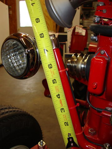

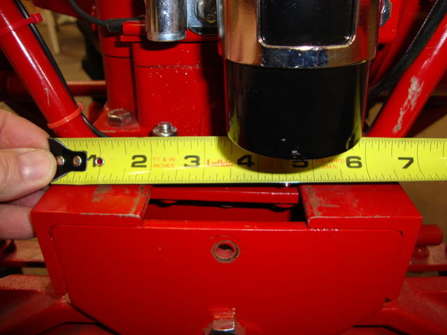

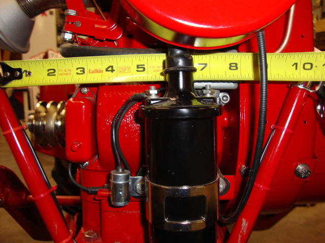

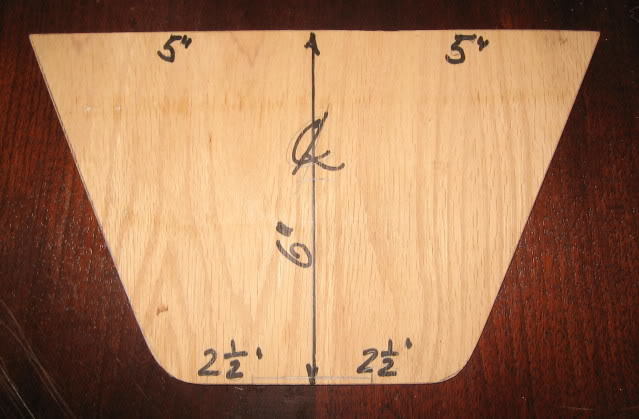

RedRanger 1,470 #3 Posted September 19, 2016 30 minutes ago, JERSEYHAWG / Glenn said: They look great. I wish someone would reproduce those. Glenn Make your own. Switch is still available new and the lights can be found on Ebay. I made my own replica bracket and have the entire set up working for under $150. There are threads on this site with the template and dimensions that I followed. 7 Share this post Link to post Share on other sites
ACman 7,741 #4 Posted September 19, 2016 1 hour ago, JERSEYHAWG / Glenn said: They look great. I wish someone would reproduce those. Glenn Are these lights VW fog lamps? That's the closest that I found on anyone know ? Share this post Link to post Share on other sites
RedRanger 1,470 #5 Posted September 19, 2016 (edited) 35 minutes ago, ACman said: Are these lights VW fog lamps? That's the closest that I found on anyone know ? I always searched for vintage back up lights or vintage reverse lights. There are a few different brands that were used. Took a few weeks of waiting and they showed up. PMCO 401 works as well as Pioneer 400. There is also a brand with more of a pointed lense out there. Of course, make sure you find 12volt, as some of the vintage auto stuff is 6volt. Edited September 19, 2016 by RedRanger 3 Share this post Link to post Share on other sites
