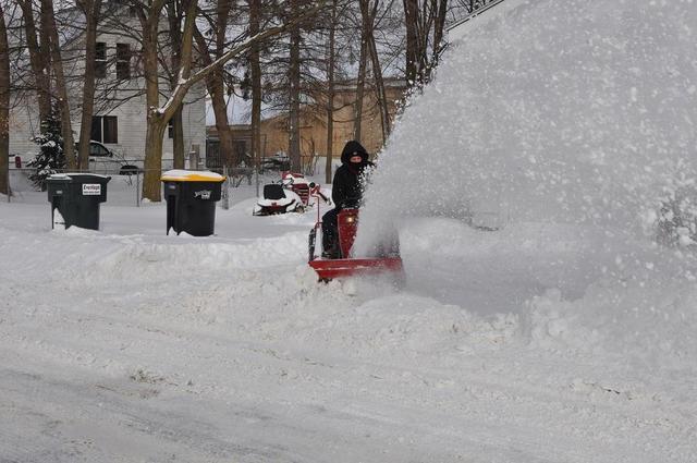

TIGman 2,006 #2 Posted September 19, 2016 Not sure of model number, but I have a friend with a GT 14 and I believe that is a single stage snow thrower that he has on his currently. Here's the one my friend has on his GT 14. 2 Share this post Link to post Share on other sites
